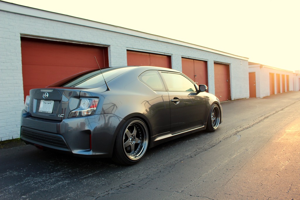

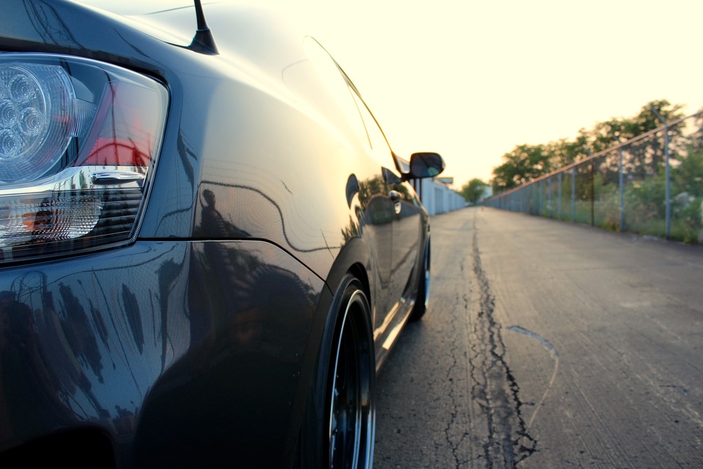

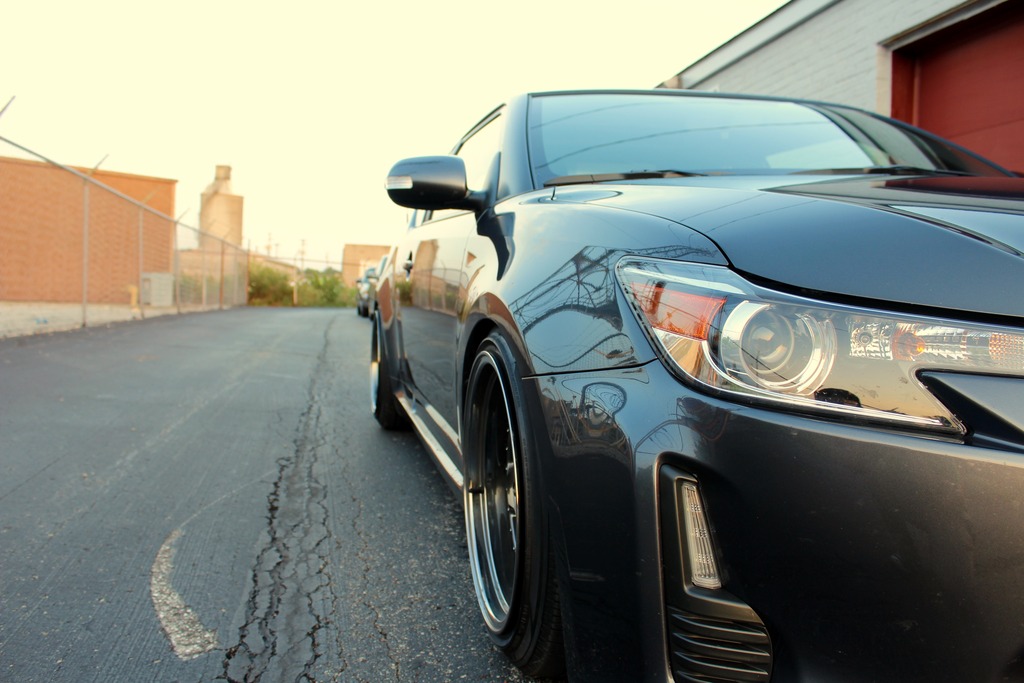

Figured I would post in this just to share some info.
18x10 et30
225/45/18 tires
No fender rolling needed, no excess rubbing either. (only rubs the fender liner clips whenever i make a hard turn)
