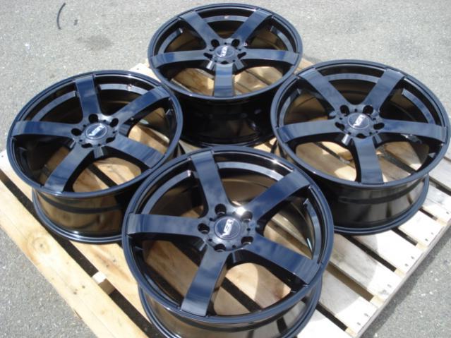

Default fitment question
Hi Guys, I am looking at some rims for my tc2 and I am wondering if these will fit the stock tires for the 2011 scion TC.
Size: 18 "x 8"
Bolt Pattern: 5x114.3
Off Set: +45mm
Finish: Full Black
thanks!
Old Apr 11, 2012 | 02:04 AM
  #106
Blackedout011TC's Avatar
Joined: Dec 2010
Posts: 704
From: North Augusta, SC
Yes the stock tires will go on safely no problem. A few guys are running them on 18x9.5" wheels no problems... The +45 offset is what I and 90% of us would avoid. You will not like it later, but it is up to you. Go to a +35 offset at a minimum. I'd go to a 8.5" or 9" wide wheel myself. Don't be in a rush to order wheels, they are expensive and once you mount them you can't return them.
