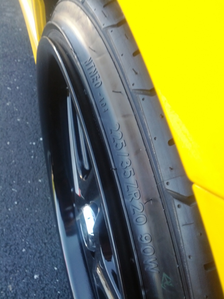

You should be fine. I put in pictures of my tC. the wheels are Lorenzo 20x9.5 +35. You can see the fitment is perfectly flush. I am running a 225/35 tire
so you can see I have a decent stretch. I, too have KSports on the way and I intend to utilize the full drop. At full drop you will need rolled fenders.
Hope this helps.
