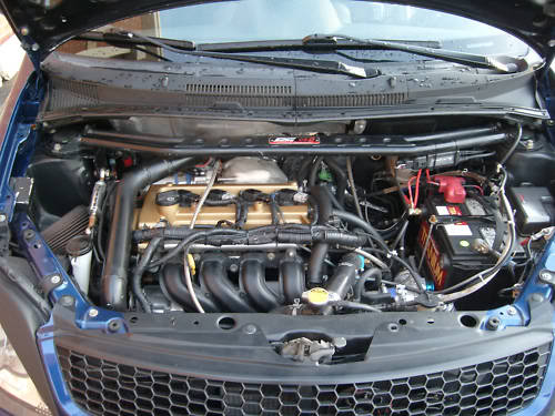

And here's something lurking in the back lol
uber-xA-RS2: what'd you have to do to get all that to fit in there??? it took me and 2 other guys hours to get the fitment down right! and even then the bay was still cram'd packed. didnt have much space at all to spare. looks sweeeet btw!
The engine bay is an incredibly tight fit. The intercooler pipes were custom made for the car and it has no AC parts in it at all. The engine was built off the car and the transmission and engine were put in as one unit from the top of the engine bay. To do minor service l such as belts or plugs the hot side of the piping has to be removed. Several days of planning and test fitting was needed to get it all in there.
