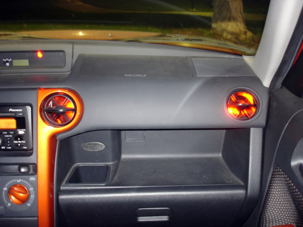

The pics below were all taken at night from the back seat with the dome light off. Pics 1 and 3 were taken using "high" flash, and 2 was done using "low" flash. My camera doesn't go wide enough to get all 4 vents in 1 clear shot. I tried a few using no flash, but they came out too dark and all you could make out were orange fireballs, but you can see even with high flash, how bright they are. At night, they look amazing; the pics really don’t do them much justice. Sorry that they are a little blurry, I don’t have a tripod, and I just burned one up before I went out to take the pics, but all in all, you get the idea... and yes, I know I need to clean the inside of my car, I haven't had it washed in like 3 weeks... Yikes!
All in all I am very happy with the way they came out. There is no glare on the windshield at night, and they light up the dash and cockpit just enough in dark conditions for my taste. The Led's are the same color as my Scion illumination, so all matches nice and looks good.
