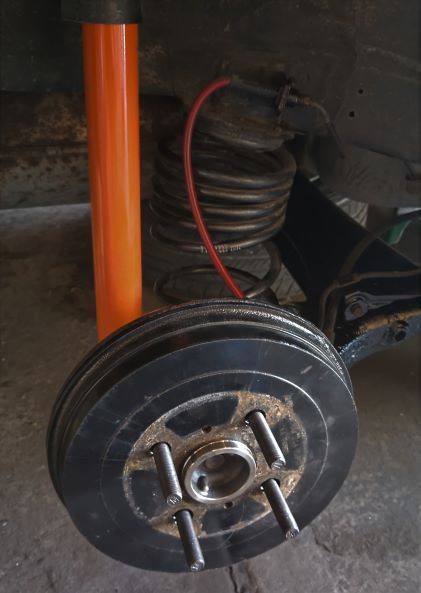

The hubs, braided brake lines, lugs and poly axle bushings are all brand new. I'm really excited by the progress and am looking forward to getting the front suspension done this month as soon as I get my grubby paws on the remaining parts I need. I'd also like to offer some comments on removing rusted, fifteen year old hubs. First of all, best of luck trying to use a slide hammer. All I managed to do with it is annoy my neighbors for three straight days. You also aren't likely to have much success using bolts, nuts and washers on the flange side as an improvised puller. Your best bet is to get some longer bolts (M8x1.25, I think - about four inches long), thread them in just like the stock ones go and then mercilessly wail on them from the inside with the biggest hammer you can find. I probably should have taken some additional photos and done a little write-up, so apologies for failing to do so. My anger and frustration were at record levels.
