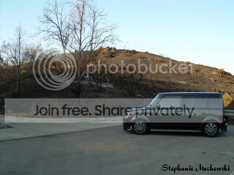

Do what I did. Paint your hubs and rock it!!

MmmBoxy,
They already have the trim rings, lugs and center caps. Yours are nice but they are still caps and you can tell.
When you painted your caps you should have run 1/2 inch masking tape down the center of the spokes first then clearcoated for a unique look.
Old Jun 8, 2007 | 05:06 AM
___MmmBoxy___'s Avatar
Posts: 1,501
From: Irvine, Ca.
I just wanted something simple to do. I was bored.......thanks for the advise though! I might do that next time I get bored!!
And I know you can tell....I'm not trying to fake that they are wheels or anything. haha!
