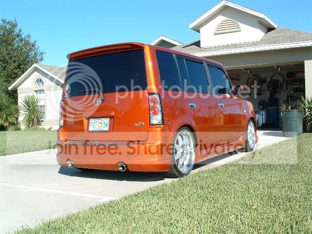

I origonally just cut the stock one with a jig saw (tape some kind of cloth to bottom of saw so not to scratch the paint). It looked ok, but you could see that one did not have a lip around the opening. To get the new opening to math the stock one, you will need someone who does plastic welding to make the inside lip for you. I could not find anyone in my area to do it.
I've got the kenstyle lip kit now (the knock off fiberglass one) and made the opening myself. Fiberglass is much easier to work with than abs plastic.
[img].
Good luck with the mod! Twice pipes rule![/img]
