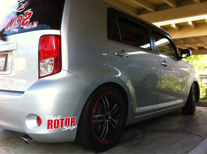

Stock Rotors
Wheel removed
Hope that helped.. Adam
www.ThatRotorShop.com (I have 3 pages of Scions and have had no problems with any of the Rotors)
