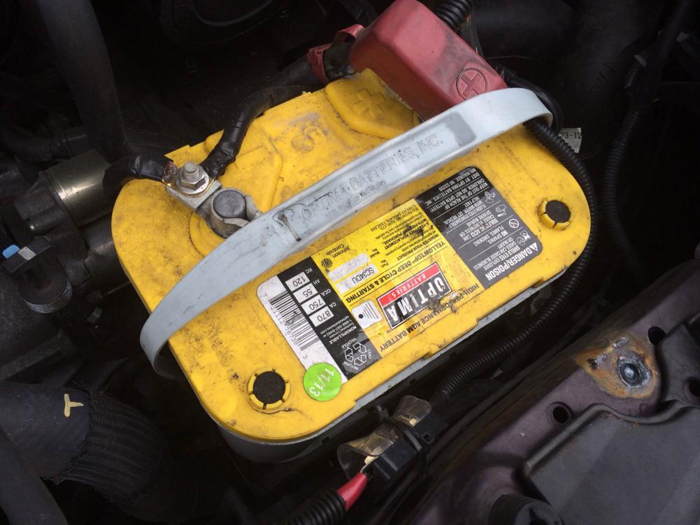

Almost couldn't control my box today making a turn.....was heading into work and was making right onto ventura blvd from balboa (I live in SFV so pardon me), and as I was turning, all these sparks came from the left side of my hood and I lost power to the car temporarily (power steering went out for a couple seconds). As i kept driving down ventura to work my car kept going off and on. finally I pulled over, popped my hood and my yellow top battery is slightly moving. I try re positioning it and it kept sparking up. Found out what the problem was.
The guy who installed my battery tried using the OEM mounting bar (which of course wont fit because its a bigger battery, so he wedge a piece of wood in there to hold it.) Well. Back to when I was trying to reposition the battery, it sparked even more. Come to find out, it was the metal bar touching the positive cable line. It got to the point where it was so damn from sparking that the bolt holding it from the other side snapped off. So now I got to figure out how to mount my battery without it moving. I was able to get to work which was only a couple blocks down from where I pulled over at...the battery doesnt move that much but I don't trust it and need a way to make sure its extremely secure, in case i go over bumps or etc.
Anyone have any ideas? See pics.

A switch over to a universal j-bolt set-up would probably work.
Here's an example;
http://www.oreillyauto.com/site/c/de...0363&ppt=C0005
You can get them at most any auto parts store.

Thanks for the response Greg.
Please excuse me for asking a dumb question but will this mount to where the OEM bar was at? cause now I have to figure out to get the broken bolt out, that you see in the pictures. I didnt have much time to fully check it out since I was rushing to get to work. Hopefully what you shared will work perfectly fine.

Greg -
Yesterday I was about to buy that mount you showed in your response at orielly's but was looking at my battery and only thought i had to mount it to where the old one was at. during the time I was checking that out, I did notice that the tray you are mentioning right now is moving around...like it's not seated right. I'm taking it that's the tray you are referring to? Ill check again later as I'm at work right now. In the mean time I just got a heavy duty ziptie and ziptied it to the frame by the headlights.
