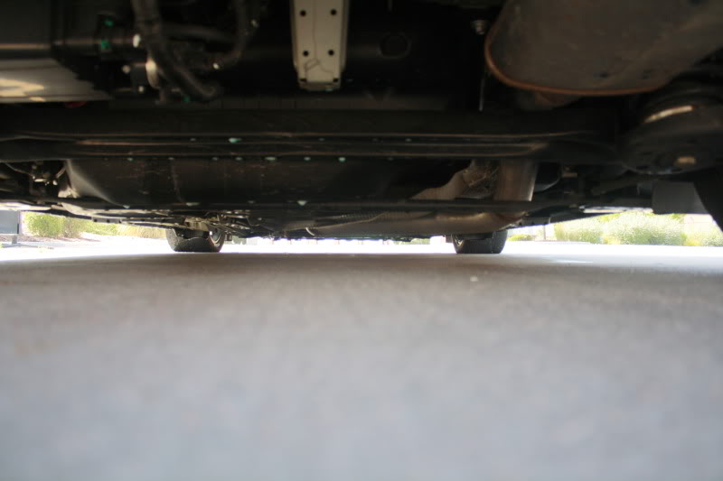

i love my 3 inch exhaust from my turbo back with a resonator where the scuba was and a magnaflow muffler on the rear with just a turn down here is a pic
not visible so not flashy

Nice stealth exhaust Cory. Your exhaust guy did a nice job of tucking 3" through there. The CXR mid-pipe hangs a lot lower in front of the rear axle. I couldn't help but notice that you have very little gap between the axle and your pipe. Does it hit often?
Prettiest downpipe I've ever seen.
