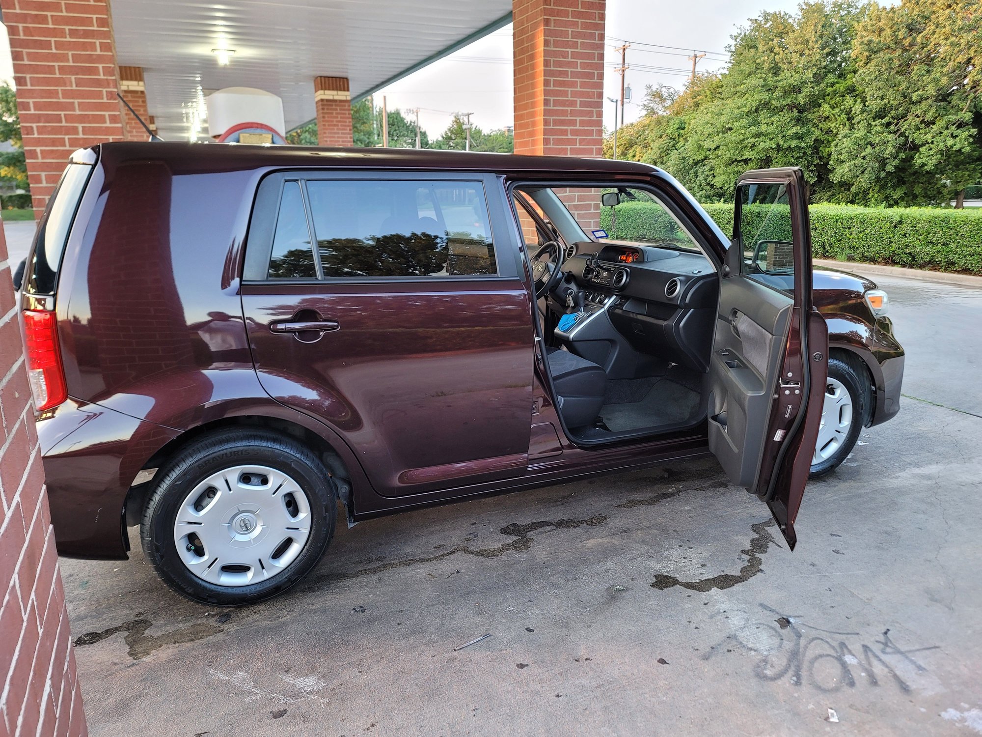

cannonierd's Avatar
Joined: Mar 2022
Posts: 31
From: TX
Originally Posted by BulldogDan
My 2012 didn’t use a drop of oil @107k but I recently sold it.
My 2012 SCION XB.
No oil issues yet but dealing with some rough idle.
