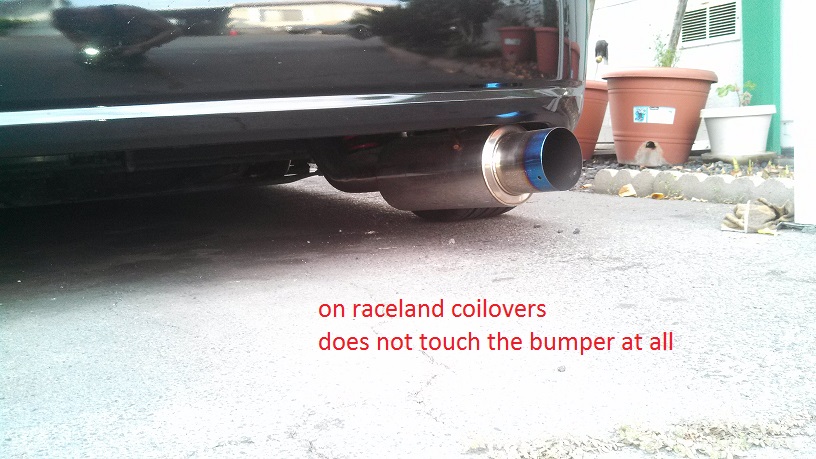

It does hang kind of low, maybe you can make a cut out into the rear bumper. Also, is the exhaust touching the bumper?

a buddy of mine happen to hook me up with this =)
