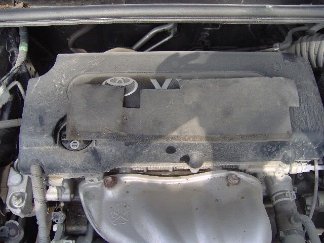

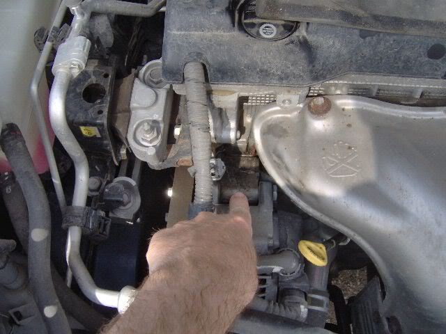

there is a glob of oil stained white putty. at the point of the leak.
while i was at it, does anyone know where this foam piece goes? i found it during a previous oil change. when i pulled the oil filter flap open. it was just lying there.
here are full screen images.

here's two more close up. the first came out a little blurry. if you tilt your head to the right. it isn't so bad. and is a little easier to make out the picture. lol
and the full screen

nice big pics. i can see the ones from my regular pic host. somethings not right though. i keep having to log in.

Old Mar 28, 2011 | 04:19 AM
tc-guy's Avatar
Posts: 1,823
that is definitely a timing chain cover starting to leak. that white or more like silver glob is the factory fipg. its not as good as the black fipg. gonna need a teardown to re seal the timing cover. that is usually the site where it leaks and on the backside of the timing cover too.
