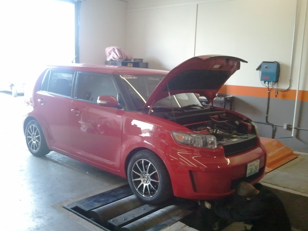

Well i finaly went to they dyno today. i felt out of place as i was the only toyota in gang of hondas lol. Dyno is a Mustang Dynamometer.
Mods:
Weapon R Header
Weapon R S-Pipe
Tenzo R Intake
Strup Cat-Back
Still have stock scuba tank.
Video link at bottom!
Came in at:
WHP 148
fT-Lbs 154
not to bad. did about 10 runs and they were all around that + or - 1-2hp.

Please excuse, but are these numbers wheel or flywheel? I looked at the printout, but if it's there, I didn't spot it.
Old May 30, 2011 | 12:23 AM
r2d2michael's Avatar
Joined: May 2010
Posts: 723
From: Tacoma area
sorry i thought i put wheel on there. but it is Wheel NOT flywheel
Old May 30, 2011 | 12:47 AM
TrevorS's Avatar
Posts: 2,778
From: DE
Got it, thanks! Can't say I've a lot of experience with this, but given it's an auto, those numbers seem pretty good !

after looking at looks like the avg stock auto is 125. so im at 148whp. thats 23whp! i think thats good for bolt ons anyway. total it cost about 900 i would say. all in all i am now on par with a stock 5 speed lol

Curious as to what size wheels and tires you're running, they look good!
