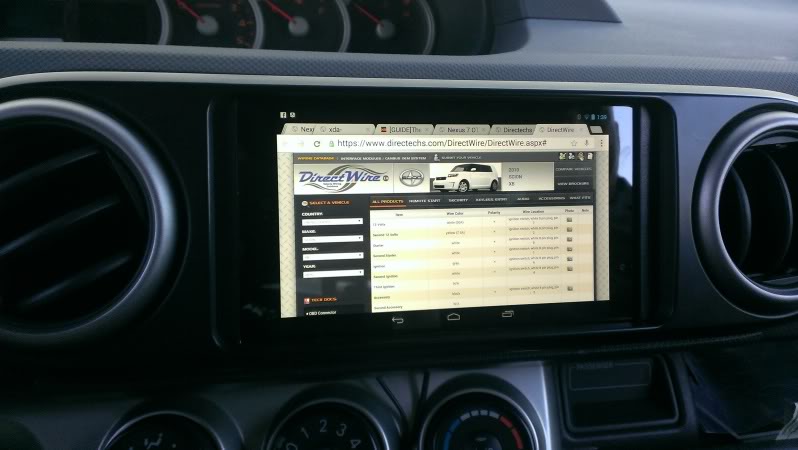

Still working fine. Only thing I did since the install was to reposition the yall sensor to match the factory orientation, but the location I chose remained the same. The way I had was okay around town and on some curves by my house, but once you get on it the traction control would kick in, and I almost hit a guardrail going up Mt St Helens a couple of months back with two friends in the car with me. After that I repositioned the sensor and I've had no issues since.
I'd recommend this for anybody, in fact I'm thinking of possibly adding another smaller tablet in the dash behind the steering wheel strictly for some gauges after my turbo install.

I don't. I set the tablet up so that as long as it has power it'll stay on, but once power is off it goes to sleep. I also set the sleep mode to 15secs and it'll turn off at about the same time as the dome light.

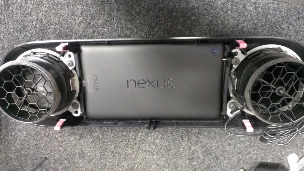

So without realizing it I ended up doing the same kinda tablet you did. Mine is the 2013 version. Quad core processor. I just redid my entire system so here is the pics of the tablet and how I mounted it. I made a sleep button mounted at the bottom so I can manually turn it on and off. I chose this tablet because of its built in storage @ 32gb and gps antenna. I use my cell phone as a hot spot using the pdanet app cost about $7-8.
I shaved down the top and bottom pieces behind the panel. to fit correctly, use some soft side of velcro to help hold in place and prevent any scratching.
I reused the mounting kit from my double din kenwood I had and shaved them down on the back side and held in place with tape plastic welded behind the panel and used some hot glue to help hold in place.

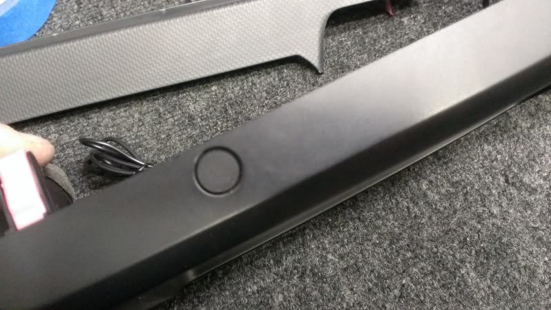

Here is my sleep button, I took a leftover part from a JVC stereo that is normally used for rear support removed the rubber piece, took it down in size to fit in place, drilled a hole using a unibit until it fit perfectly. I had to fill the inside of the rubber to prevent deforming. I dont have a picture but I used another piece of strap to hold the button in place.

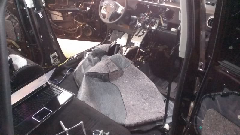

After laying down mat on the floor and getting the 5ch amp in
One layer of mat on the inner and outer skins, I plan on doing one more on the outer and filling the openings. Still need to do the back doors
