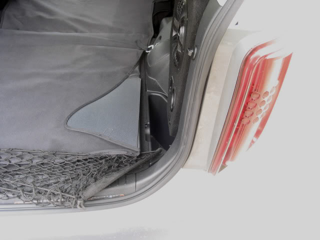

Just replaced the blue tinted upper photo and here's another .
Seems to me the right side tray corner may have relaxed down a little more, however, there still isn't room for the cargo liner flap. I'm concluding the design just didn't allow for it. I guess that's legitimate since it is just an accessory, would have been nice though ! In any case, it's impressive how closely the cabinet follows the contours of that corner, including the pocket behind it.

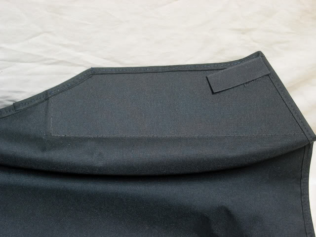

Resolved the cargo liner fit problem!
Probably could have kept another 1/4", but it seems to work fine !
