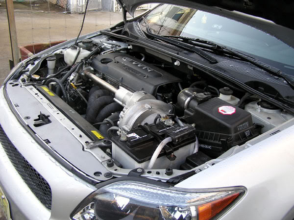

get a power distribution block.
Amazon Amazon
i ran short 0guage to it, and 4 guage to my amps.
I velcoed the block on top the battery.
