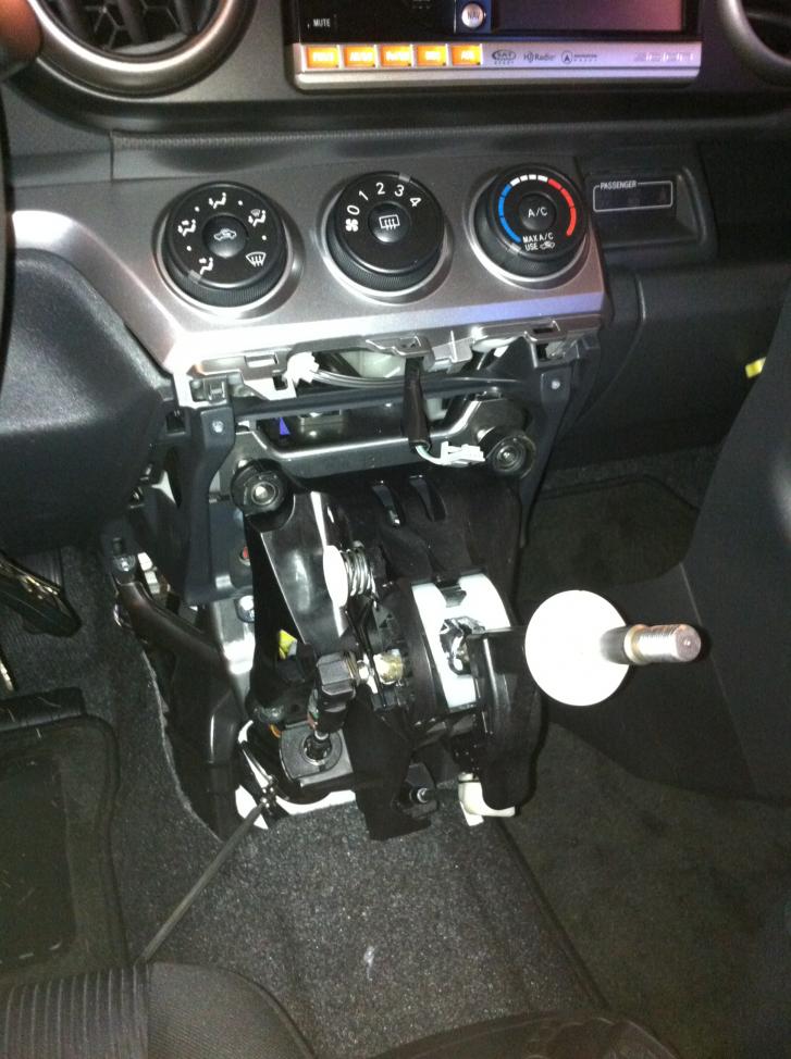

Ok. First, the fog light relay is located behind the shifter in the center console. Kind of hard to get to. I think that Scion didn't want anyone to do this. I didn't take pics of taking the center console apart. The gear shift know spins off by turning it counter-clockwise. Then the gear shifter trim pops up. The lower tunnel has two screws at the top then pulls straight forward. With it removed it should look like this.

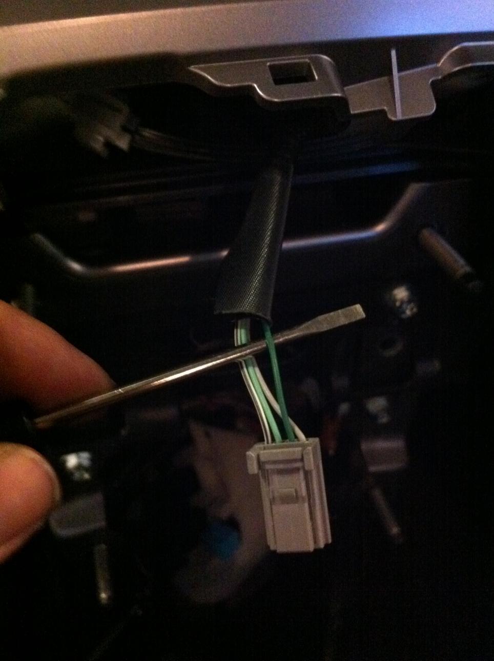

The wire shown it this pic is the illumination wire from the hazard switch. I used this wire to power the relay only when the interior lights were on. This way when I turned the parking lights off, it would turn off the fog lights. If you wanted to turn on just the fog lights with no parking lights, you could give it a hot wire that provides power. You can use a switched power that is only hot with the ignition on or you could use a hot wire with power even when the ignition is off. I wouldn't recomment that because you may forget to turn them off and kill the battery.

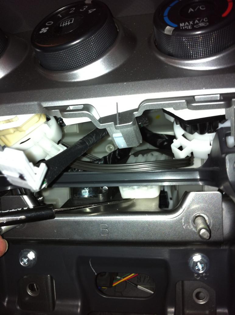

I used a tap and a wire with two spate ends to connect the wires. This is a pic at the hazard switch.

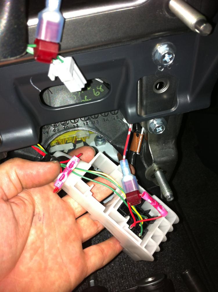

Ok here is the deal now. The fog light relay gets power from the headlights on the two red wires. These same wires also power the indicator in the dash that shows the headlights are on. I cut both red wires that went into the relay and butt connected them together. (On the left by my thumb.) This is necessary to have the headlights turn on the indicator in the instrument cluster. Make sure, when you cut the wires to the relay, that you leave enough wire going into the relay to connect them to the other wire from the hazard switch. (or whatever you are using as your power source). I butt connected them together and connected the wire from the hazard switch with another T-tap. (On the right). I did it this way because I already had it tapped from before I cut the wires. You could just use a butt connector to connect the leads at the relay directly to the wire tapped into the hazard switch. This is what it looked like when I was done. You can see in the pic that I ran the power wire, from the hazard switch to the relay, behind the console so that it didn't get pinched by a panel.
