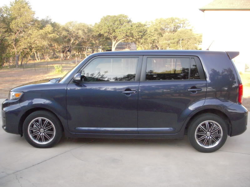

I am thinking of lowering it a tad. I would think this may improve mpg as well as looks. Also, I am wondering if my cheap after market wheels are heavier and cause more drag than the factory steelies. Here is my ride. what do you think?

Drop it on NF210's... mild 1" drop up front, slightly heavier 1.7" drop in the rear that will even out the jacked up rear ride height a lot, and provide a very comfortable ride. I would not expect any improvement in mpg with the drop. I have NF's and saw no measurable change in mpg when I put them on, which was 36k miles before I got rid of the steelies.
https://www.scionlife.com/forums/sho...d.php?t=124875
Those Hot Wheels have to weigh at least 5 lbs. more each than the steelies, so yea, they will definitely lower your city mpg. The heavier wheels have the most negative affect on acceleration and mpg in stop-n-go driving, but not so much when up to cruising speed on the highway.

It looks a lot nicer lowered. I think I will go for those, if I decide to keep the box. I guess I will have to wait until the factory tires (goodyear eagles) wear out before switching to nicer and hopefully lighter 18s. I won't go cheapo on the rims this time around. I would hope that lowering would give at least 1 mpg. I was looking at the new honda civic and they have a 41 mpg version and the only diff between that one and the regular honda civic (39mpg) is that it is lowered 1", has different wheel covers, and the underside is enclosed. So, 1 mpg would be the expectation on lowering the box. I was just wondering if anyone else saw mpg improvements after lowering.
