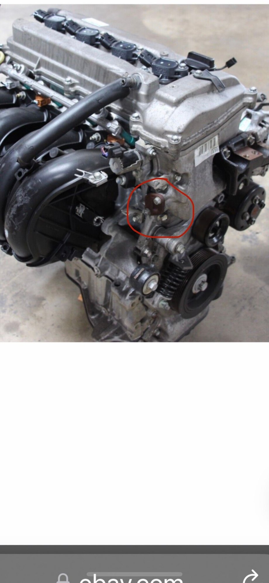

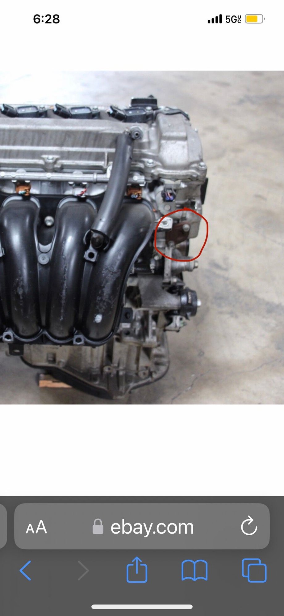

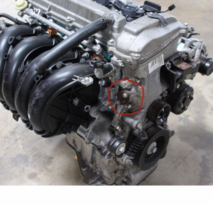

I believe this is the culprit that’s causing a pretty bad leak. Does anyone know what this is??

So I ended up removing the thing. Turns out it’s the timing chain tensioner.
It has a very thing gasket. I re-used the same gasket and added RTV Sealant on both sides of gasket. Hope this helps somebody
