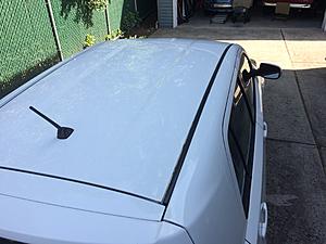

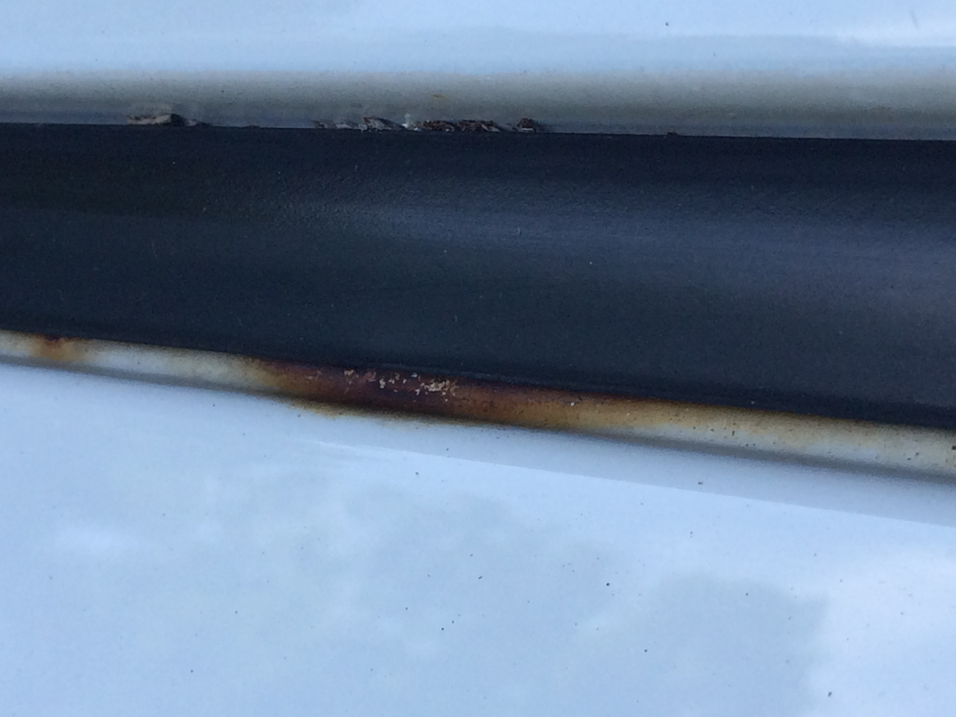

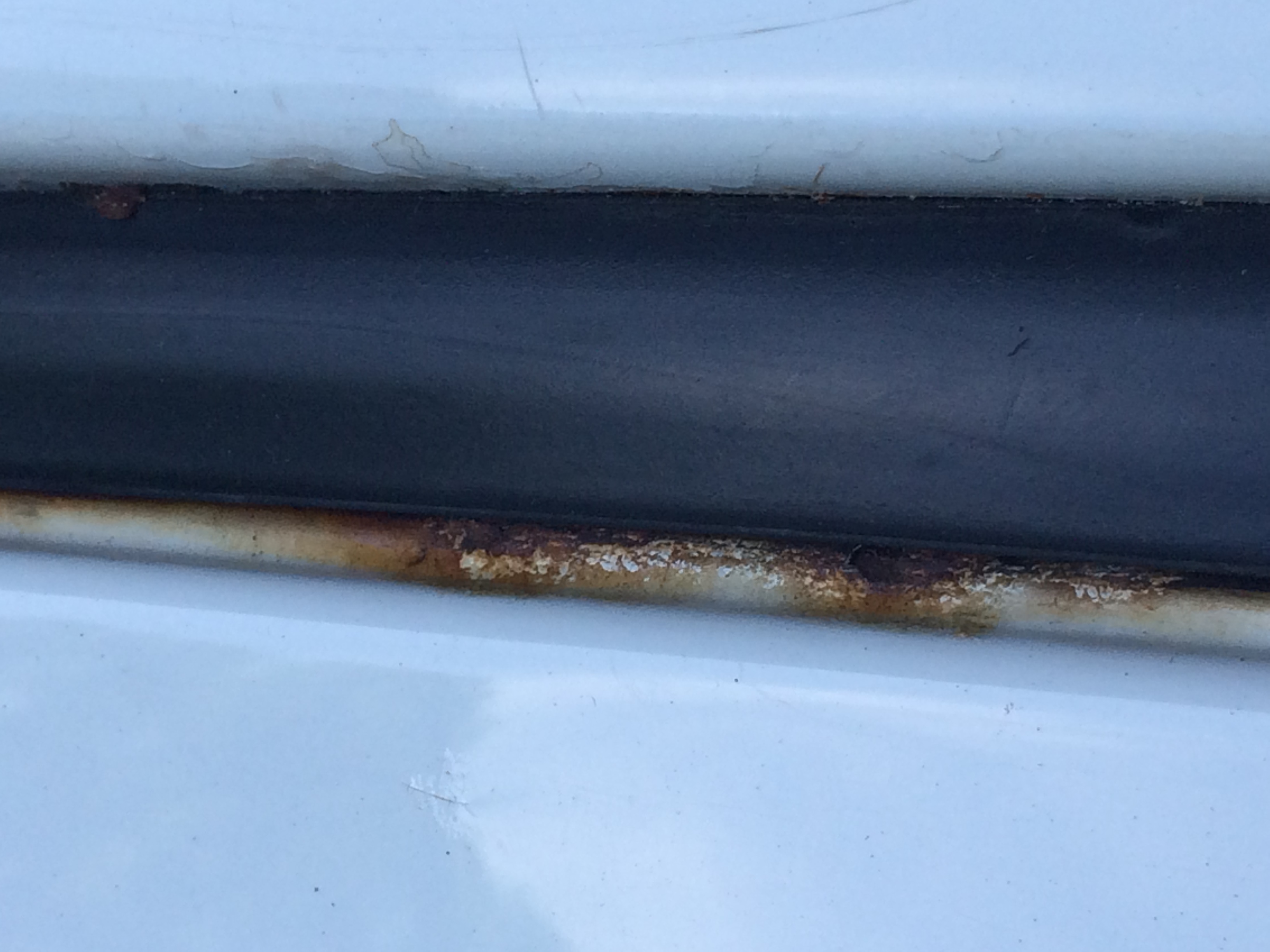

I am a new member and I just acquired an '09 xD from my daughter who purchased it new. Yesterday a gave it a good washing and waxing. I found that there is rust forming under the two black vinyl strips that run the length of the car from front to rear.
It's that kind or rust that bubbles up from below the paint and quickly spreads. I'll try to post some photos of it. It looks like like dirt, rotten leaves and tree debris has accumulated there and caused the rot. I'm wondering if anyone else has had this problem.
I would like to remove both strips, repair the damage, and leave the strips out so it doesn't happen again. Does anyone know if these strips serve any purpose other than esthetics?

I could be wrong, but, I THINK those are your Drip Moldings #13 on the Top of your Roof.
The name implies they are to help channel the drips/ water on your roof. If you were to remove them
then you are left with drip gutters, minus moldings. What you 1st have to consider that on a 9 year old vehicle whether the rust from the moldings have cause rust and corrosion to the paint on the drip channels.
If you are lucky, maybe you can use use some kind of rubbing / polish compound to remove the surface rust and you are home free. If that is the case you can decide on whether or Not Replacing the Moldings
and just go with the channels / drip gutter as is w/o the strips.
I also THINK they also serve as Rub / Glide Strips in case someone want to mount or attach a box or carrier on top. They serve as a small bumper strips nears the edges so as not scratch the paint.

Thanks for the information. The moulding/strips definitely need to be removed to get at the rust because I see the the strips are lifting slightly, the rust is formed under them and I don't want to let it go another minute - I'm afraid that it may rust through the roof.
I will prep, prime and paint and replace the strips with new. I want to order the strips and item #14 the retainer clips - it looks like there are two clips per side but I will double check with Toyota.
