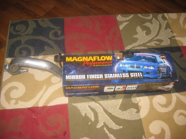

I purchased the Precision axle-back myself as well after reading about it on this thread where someone was inquiring as to the potential existence of a magnaflow cat-back system for our cars. Like most folks have said, the installation process was quite simple, I backed my car up on ramps, unbolted the stock muffler, and bolted on the precision canister. The hardest part for me was getting the stock mufler's rubber hangers off their respective mounts and then re-hanging the included precision hangers without dropping the muffler on me or the concrete below. I saved my stock muffler just in case a cop and I don't see eye to eye somewhere down the road. Even though I'm sure this new muffler doesn't come close to violating any noise regulations where I live, the interpretation of the rules is entirely up to the guy who pulls you over. I could just see 'illegally modified exhaust' being added the bill whilst being pulled over for something else (knock on wood only one ticket in almost 14 years which is amazing considering the way I drive sometimes ).
My buying experience was excellent. I found Gabe at precision muffler to be lightning fast on email response to questions. The one concern I had was that when I put the 2 flanges together, it appeared that in order to get a decent seal, I had to screw the bolts pretty tight. The result was that the washer springs were entirely compressed. (see pic)
I emailed Gabe about this, and he said that it wasn't any cause for concern and that it would just allow for more play later on. I imagine the parts will probably seat better as they continue to heat, cool, and vibrate over time. There do not appear to be any leak issues. He[Gabe] also said that it takes about a week for the motor to adjust to the new muffler and that the sound actually deepens considerably over this span of time. I've had the muffler on now for a couple of days and it does appear to broaden the power band a little bit in addition to sounding pretty nice already. I'm thinking about combining this with an HPS short ram intake maybe with next month's paycheck and seeing what comes of it. I usually accelerate and shift for good mileage, but this is getting much harder to do lately.
