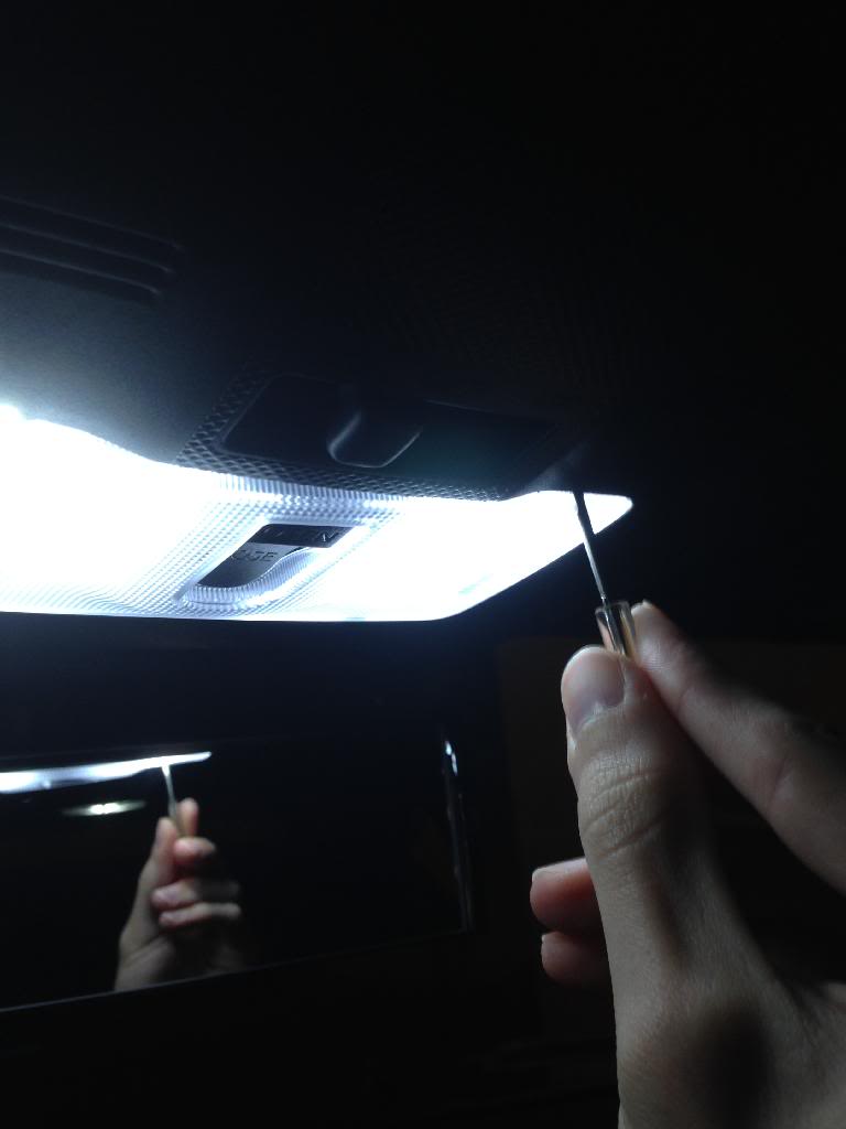

Attachment 22172
us a tiny flathead screw driver and lightly push it it and prey the plastic to slide out. there are two spots, do to each spot before pulling out.
Attachment 22173
Attachment 22174
after you have preyed it out a little you can use your fingers to slowly pull it out.

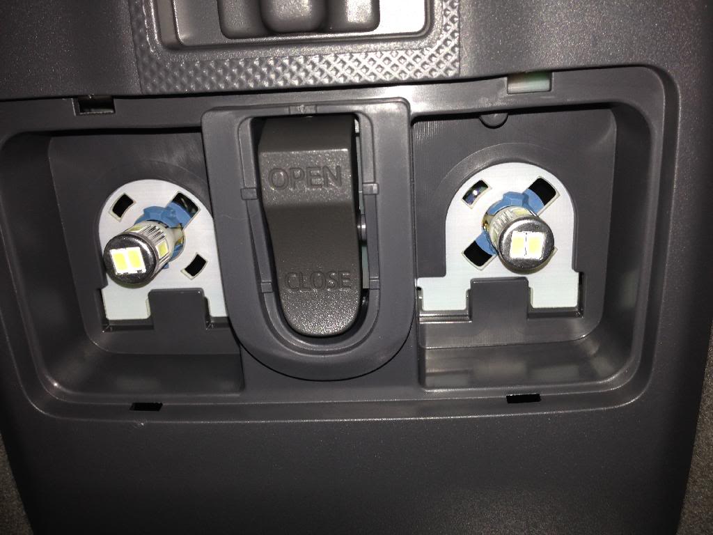

Attachment 22175
then just pull out the old bulbs and slide the new in.
(note: you might have to prey the prongs of the LED base on both sides before sliding it in to make contact, only do if the bulb will not light up.)
Attachment 22176

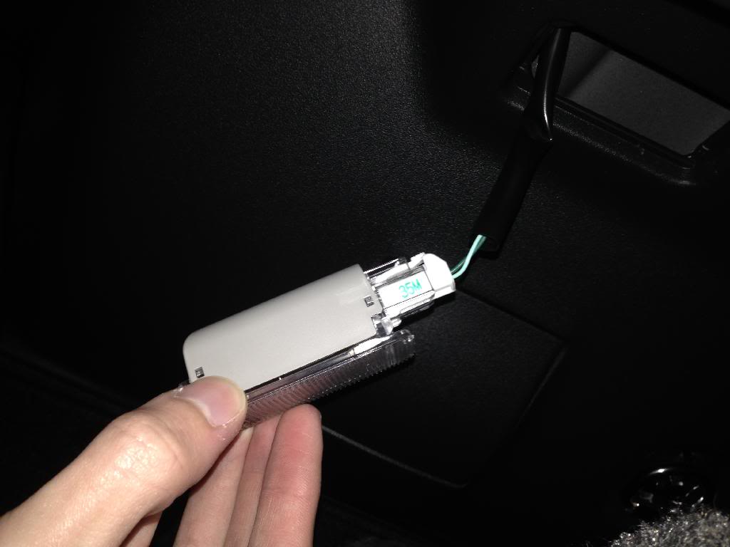

now the trunk
use your tiny flat head again in this spot to slowing prey out the light, if you are doing it right it will pop out easy.
Attachment 22177
now unplug it
Attachment 22178
the tanish color plastic you have to just pop each of the four corners off to get to the bulb

nice! post pics when you do it, also a warning i forgot about, when doing the map lights, that blue piece the bulbs go into, be careful with them, they move easily if i remember and a pain to fish around to get them in place again.
