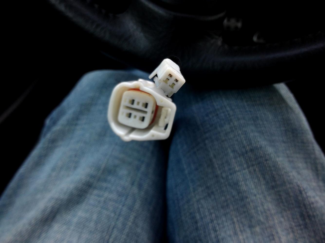

2005 doesn't have the same wiring setup. There is no yellow connector.

Drivers side has two and passenger has only one. See pics, any help is appreciated.
Attached Thumbnails Airbag Light Resistor Fix (Aftermarket Seats)-img_20121202_135456.jpg   Airbag Light Resistor Fix (Aftermarket Seats)-img_20121202_135651.jpg

Success! I SCAVENGED the harness and the little black magnetic module from the OEM seat and no more srs light. Now I can get the car inspected. LOL
Thanks TcPete for pointing out the easy way to solve this in an 05 tc.
