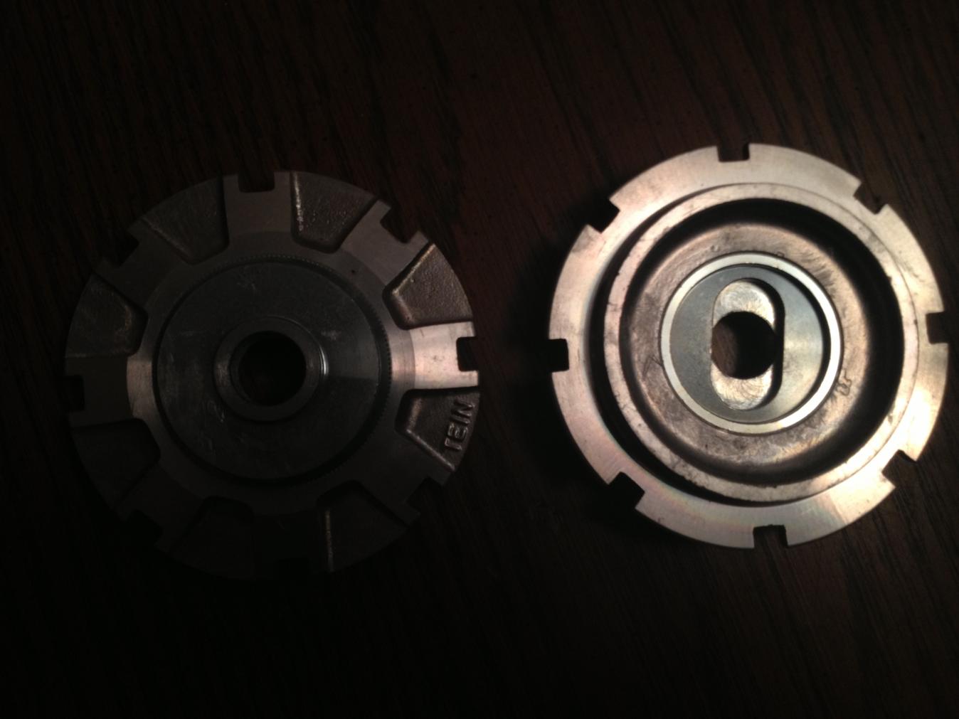

I just had tein ssp installed by a shop here in Springfield,Mo at the end of the install they had "extra" parts which automatically worried me now I've got a vibration coming from the rear and I've got a feeling I need those parts they are gold disc looking things that go on the rear coilovers I've got two of them "extra" anyone know what they are for or what they do and this will fix my issue?
Do you have pictures of the "extra pieces"? There should not be any pieces left over. The install for the SSP's is really easy and straight forward, you pull out your entire old shocks and struts, and install the SSP's. You dont swap any of the factory pieces over to the SSP's. Hopefully they did not try and put your stock hats on the Tein SSP coilovers.....

Yeah i just got some pictures of them sorry it took for the reply i generally use scion life on my iphone and couldnt figure out how to post pictures from the mobile version but anyway back on topic the extra pieces are actually silver i had gotten to thinking they were gold just looking at other pictures of tein coilovers but they are not i have a feeling that these are the top pieces to the rear coilovers and that the dumb guy used the stock rear tops but heres the picture i hope that someone can help before i spend 100s in the shop tomorrow trying to get it all figured out.
Those pieces are not for the rears, those are from the fronts....not sure what they did, but from what you are saying and those pictures, I would say its not right

Yeah I got to looking at other DIY and thought they looked like they belong on the front I'm going to go get all the tools I need today and put those on the front were they go it appears that my coilovers are identical to yours just more adjustability and what tool should I use to tighten ecerything to the appropriate torque

I appreciate the help and good advice i took them off today and put those pieces on and took the stock ones off car performsn like a different car now great diy
