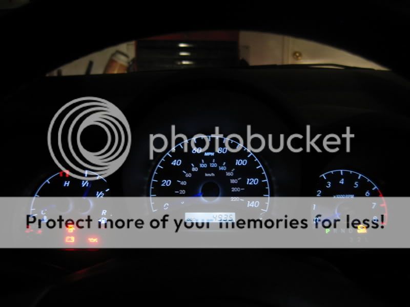

I just did my gauge in white with blue needle but somehow the needle doesn't come out like I want. It is really dark and at night, I can't see the needle very clearly at all, what am I doing wrong ? I'm using acrylic paint as well and painted it really thick
Old Sep 26, 2006 | 03:19 PM
  #362
DriveEuro's Avatar
Posts: 304
Too much paint....

then I remove all the paint and did a very light coat of paint, cover with clear nail polish and yet it still doesn't show up very nice at all, also barely visible, i'll take some pictures of this later at night and show u guys

The color you're trying to achieve might be hard to get. Are you trying for a dark blue or light blue? Cuz dark blue would obviously be hard to see. Light blue would be easy obviously.

so I got the wrong paint ? I really dont care what kinda blue, as long as it's clearly visible like the orange needle used to be

Maybe try a lighter color paint? You will have to put it on thin if its a dark color.

Yeah, I tried mixing the paint with a little bit of water to thin it out,, then did a lighter coat of paint, yet the light still doesn't shine through at all, guess I'm gonna have to go buy another paint and try
I got some blue acrylic paint at Michael

The light shines in front of the paint, not through the paint. A reflective color works best. For blue, use the Neon Blue Apple Barrel from wal mart or micheals. It works great. Put a coat of white behind that to make it reflect more.

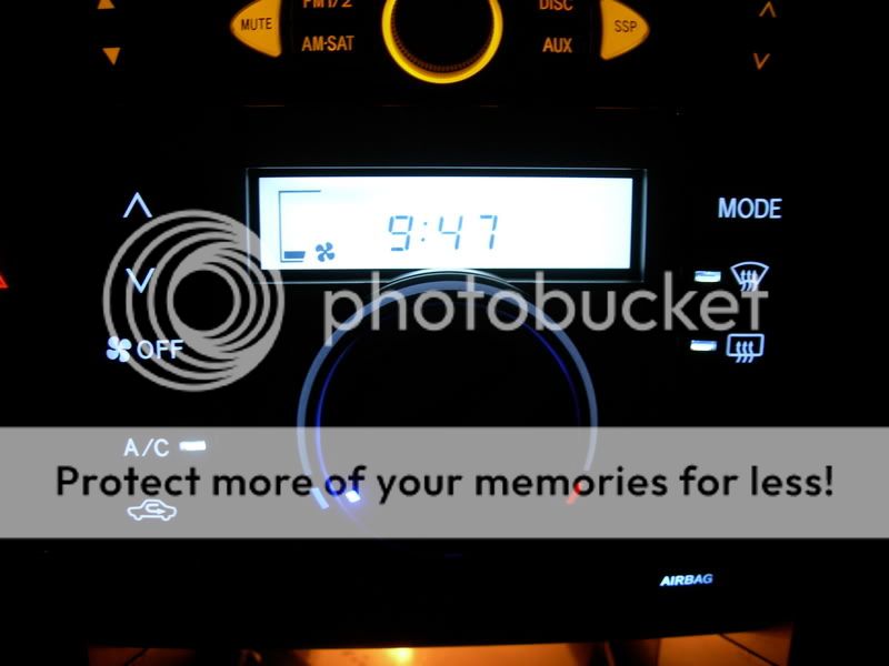

I just did the HVAC LED change today and is the word "Passenger" on top of "Airbag" supposed to lit up ?? I dont remember if it used to before or not. I looked at a few other HVAC posted in this forum but they dont even show the word Airbag lit up
Yeah, i know, the outside temp button doesn't lit up, the solder joint came off while I put the board back, it did that before, I'll have to solder that back later
Sit on the passenger seat without your seat belt on or push down hard on the seat cushion. It just indicates when someone is not wearing their seatbelt in the passenger seat. That's the only time it shows.

Actually if I remember correctly, the 07 board should display "Off" or "On". That is definitely an 07 board.
For the button not lighting up. Check your joints and trim the housing to sit over the wires and resistors you added. If you dont trim, the board will be flexed when you screw it back in and can cause undo fatigue on the solder joints down the road.
