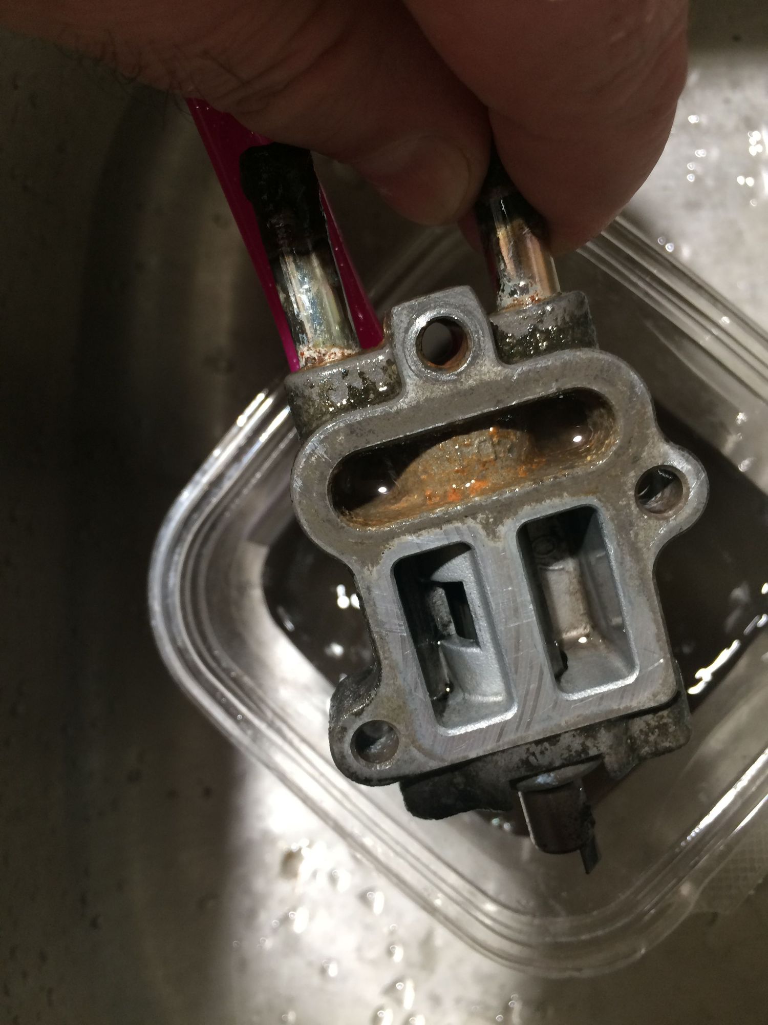

This is the throttle open. Here I use a small brush to clean the interior side. On the top area the coolant goes from one side to other. Those pipes was extremely clogged with rust inside. I even do not know if was a liquid interior circulation before cleaning.
