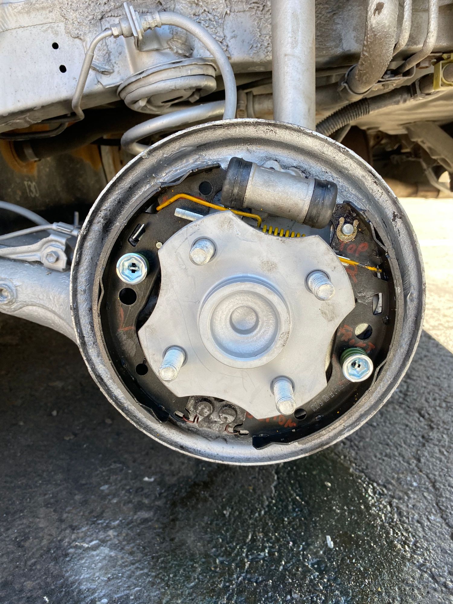

This is a final result. The hard part was to be sure that the adjuster on the left side (close to driver) holds on the back the little plate with the fork. Also to be sure that the right side (close to bumper) have the adjuster bumper in the right hole with the long fork side under the brake shoe. The bleeding will be after replacing also the rear passenger side bearing/hub drum, brake shoe, cylinder and the all little parts. Please let me know from this picture by visual observation, if is OK?
