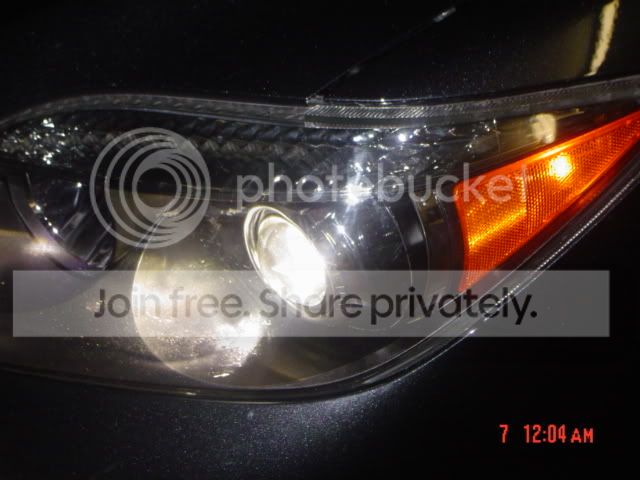

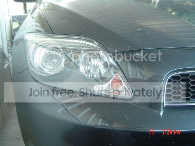

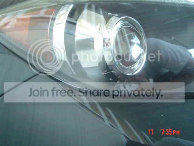

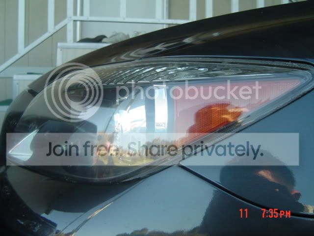

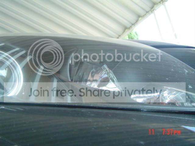

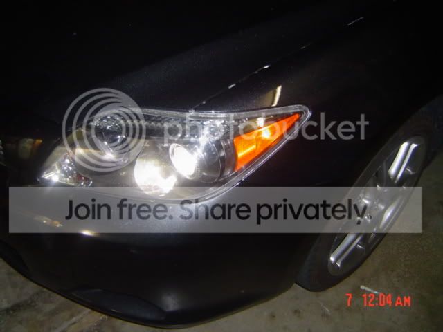

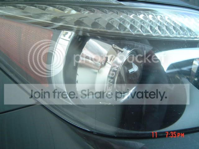

maybe i should do alot more explaining first before posting up all these pics. i've been researching on hidplanet.com for the longest time now... almost had it done by a 3rd party (350 just for labor), and have juggled several choices of projectors, bezel, exterior look etc. finally after daydreaming through finals week, i got together with my friend (blue rsx type s) and we did our retros together.
clearance (my main concern) actually worked out much better than i had expected, overall i wouldn't say it was too hard of a job. definately something that can be 'slapped' together easily but attention to detail will really pay off.

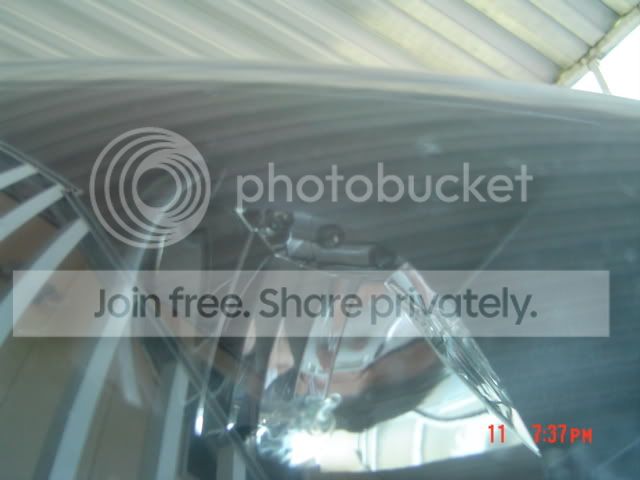

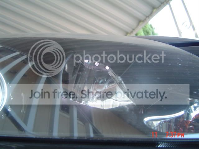

parking light mod in high beam (3x 10,000mcd white LEDs per high beam)
oh, and the leds are wired in parallel with each other, in series with a resistor to limit the current, in series again with an inline fuse (0.1a i think) just to be safe... they're spliced into the "city-lights" wire, which you can't see anymore but the hole is still there. i'll probably try sticking some super bright leds from superbrightleds.com in there to see if it'll glow through my bezel. i've realized that my bmw e46 bezel is actually semi-transparent... almost like it has a 5% or 1% mirror tint or something.
DAY SHOTS
LEDs close up
LEDs zoomed out
LEDs on (parking lights/first click)
profiles
NIGHT SHOTS
indoor garaged
money shot! (sorry i didn't have a tripod)
honda s2000 baby... worth every penny
more info & hopefully some better beam shots to come.

The projector looks hot... but do you have high beams anymore? B/c it looks like you just moved the low beam housing over into it's place...
i still have high beams, the projectors are in the low beams.
the only changes made to my high beams are LEDs hidden in the top wired to the parking lights
that's the first click. the projector is in the low beam if you look closely

my setup is actually one of the best (in my book) for the tc:
standard HID equipment that i already had
$250 - Hella Gen 3 ballasts (OEM) & Philips D2s 4100k bulbs (OEM)
$350 - Honda S2000 projectors from ebay
$300 - OEM 2005 Scion tC headlamps (optional)
~$25 - for resistors/leds etc for LED mod (optional)
as you can see, the meat of the project was $600 bucks if you can stand not driving your car for a week.
i couldn't so i got spare headlights. $600 is also with the top notch projectors.
an OEM quality HID setup can easily be achieved closer to $350 if done by yourself,
bmw and audi projectors are typically 100-150 for a pair.
when doing the setup you will hear many pops and snaps, if you get nervous, this isn't for you
i've gotten a few PMs so if anyone is interested, i could consider doing a few on the side but since i DO work 40 hours a week, don't expect me to be able to get to it right away ^_^, lets say... the cheapest setup will run you around $500 and the most expensive will be about $1500 (this includes labor but not ballasts or bulbs)
also, if anyone is local (bay area) it'd work out much easier since i have spare headlamps to lend you, process of swapping lamps takes about 30-45mins

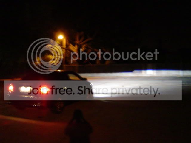

are high beams still necessary?
great job on the lights

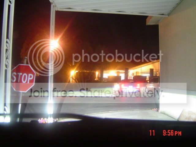

thanks, high beams are DEFINATELY necessary... if you look at some of the beam shots i posted, you will notice that the light stops right at the cutoff, there is no stray light leaking upwards, so i guess the projectors are doing their job, no glare to oncoming traffic, these will light up the road as far as you can see but if you're doing mountain driving, you'll need your highs even more often than with the stock halogens... you can see everything to the side though... this beam is wider than stock, and i was pretty impressed with the width of our stock beam.
