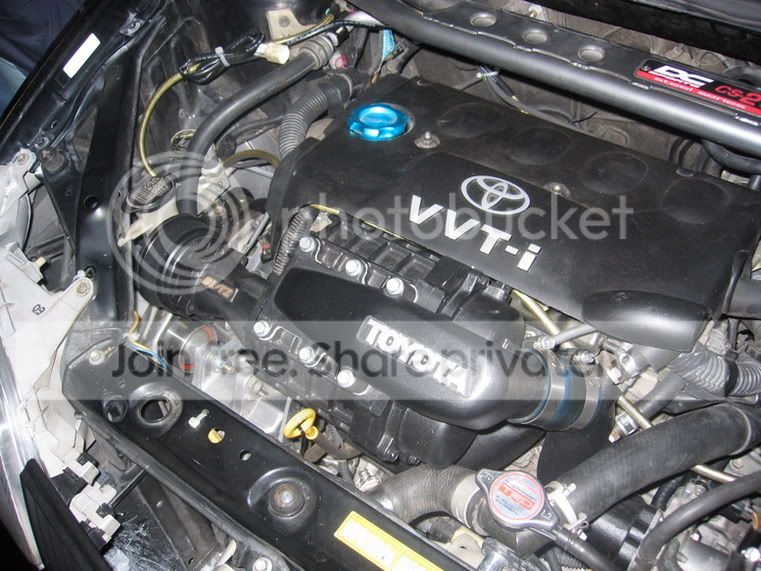

To all the supercharged xb and xa owners!!!
I would be very carefull when it comes to setting the supercharger to come on at 50% throttle or MID because the car runs really really lean... I have a wideband on mine and on cruising and then stomping on the gas the car goes pass 16:1 a/f ratio on my AEM wideband... And I'm running 230cc injectors instead of the 200cc injectors that comes stock with the 1nz-fe...
But, here something for you guys that have belt issues when it comes to slippage...
notice something different ????
Plus with that upgrade I'm hitting 7psi on 1st gear, 8 to 9 psi on top of 2nd, and 10psi at the top of 3rd...
But I dont know how its going to react to my newest and latest mod ... I just recently and successfull converted to 6spd trans. Thanx to KAAZ USA , Thanx to Mr. Ray Nakadatae and Saji and the rest of the guys at KAAZ
