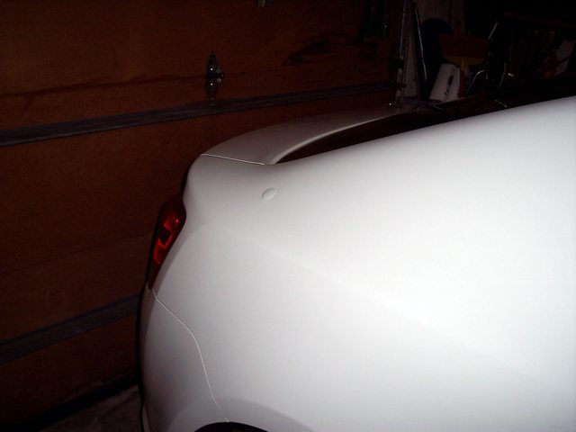

Ok so the holiday season is now over and I finally got off my ___ to complete this. Here it is...
This is the full album with the full res photos...
http://imgur.com/a/t2pj7#0
Here's the procedure...
I sanded the top layer down with 400 then 800, 1000, 1500, 2000. Primed it afterwards with a good 8 coats all around then sanded again 2000. Finally painted the actual white with 9 coats all around. I slightly chipped it as you can see in the pic if you get close down on it. I'm too lazy to go through the whole process again hehe. I think it looks good the way it is so I'm not going to bother.

How long did it take to remove the antenna ? I'm bout to do this to my 2010 tC
Old Feb 5, 2012 | 01:31 PM
oblivionlord's Avatar
Joined: Dec 2009
Posts: 494
There is a tutorial on how to do the 2010 model since it is different than the TC2. For mine it was just a matter of removing the rear panels and then unscrewing the bolts. That's pretty much it. The rubber base of the antenna unscrews off. Again the procedure may be a little different on the TC1.
