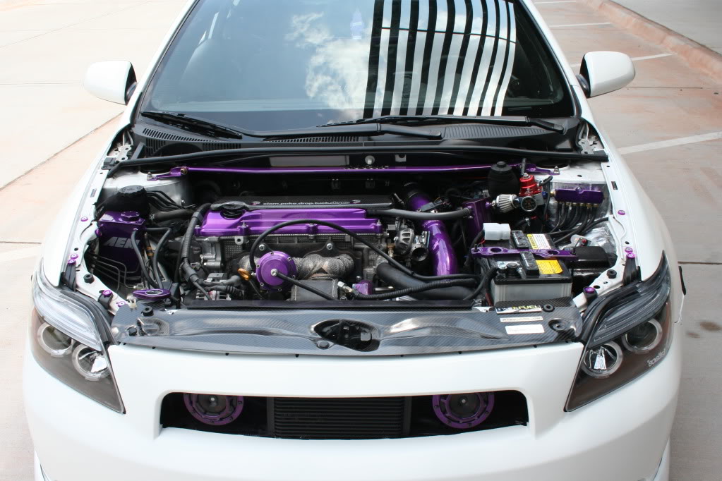

Whats up folks. Most of you guys know me (be it bad or good lol). Im back with another crazy idea. Got a project a I figured I'd start a build thread on. A little history on me, Im coming from a Scion tc that we (Abel Racing) put a custom turbo kit w/ e85 on stock motor and made 472 whp. Car was pretty quick but I hit a brick wall with FWD, weak trans and too much power. Here is piks as it sat last...

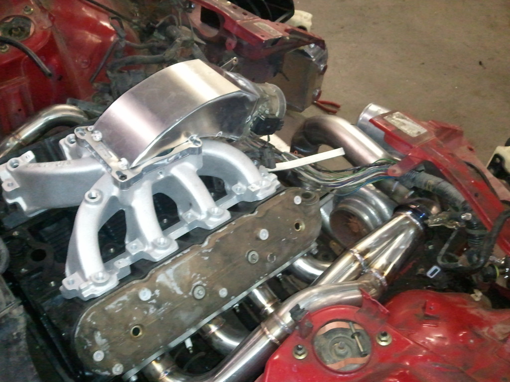

Finally got started on some fab work the other day. Again, all work done by "efeezie". Got custom solid motor mounts and manifolds made. Fitted a 4L60E auto tranny. Custom hat for Edlebrock Victor Jr. Intake is almost finished. Here are some progress piks... Sorry for cell piks. Will take better piks further down the road.

Things to get worked on next are: Air-to-water setup, getting motor to running shape with vette accessories (planning on stroking to 6.7L later down the road). Get fuel system together. Custom drive shaft, and all the little things to get it running.
