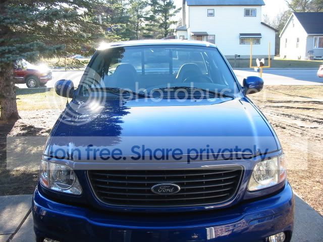

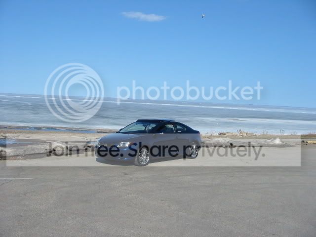

These are my first good details of the year with my new Porter Cable 7424 Polisher. I know there has been a lot of questions about this tool so hopefully these links help.
This a link to where I bought my 7424 from.
Amazon Amazon
I also used the following pad kit with the 7424.
http://www.autopia-carcare.com/tps-padkit-da.html
Here is some good information on how to use the 7424.
http://www.autopia-carcare.com/inf-pc7424.html
Here are some pic's from last weekends fun. As you can see you can get very good results with simple products if used properly. I'll be upgrading my products soon and see what kind of results can be had. Hopefully you enjoy the pic's and the links.
2005 Scion tC Indigo Ink Pearl
NXT Wash
Clay Bar Wizards Brand with Wizards Mist and Shine QDer
NXT Wash
Meguiar’s ColorX with LC White Pad on PC at speed 4
Meguiar’s Deep Crystal Systems Step 3 Carnauba Wax with LC Gray Pad at speed 3 for a topper
Removed with Wally's MF's
Stoners Invisible Glass
Eagle One Wet Tire Shine
2003 Ford Lightning Sonic Blue
NXT Wash
Clay Wizards Brand with Wizards Mist and Shine QDer
NXT Wash
Meguiar’s ColorX with LC White Pad on PC at 4
Still need to finsh up on the lightning, it's not on the road yet.
