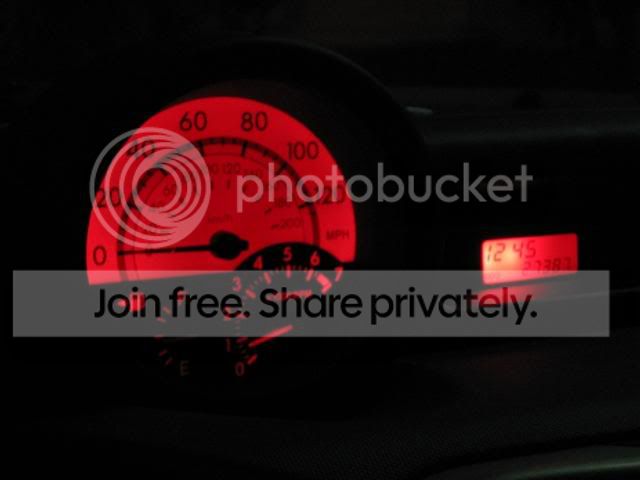

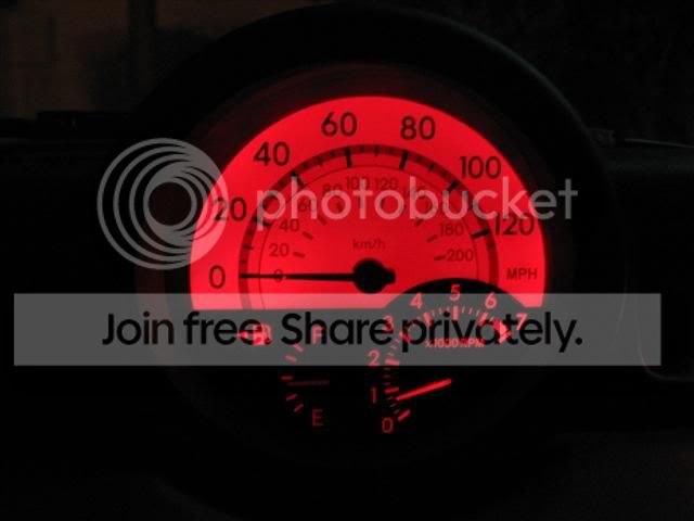

GOT DA LED'S FROM JEREMY(Garage1217) THANKS BRO! DID IT WITHOUT BREAKING DA LCD SCREEN! :D THIS IS 4 YOU CEASER! J/K STILL NEED TO DO DA A/C CONTROLS!

sweet!!...were did you get the lights??
Old Jun 27, 2006 | 08:40 AM
keoki's Avatar
Posts: 2,785
From: HAWAII 50
Garage1217.com He's one of member's here in desert&salt region. It's his website. Go check it out!

Be sure to get REALLY bright ones. I used 10,000 mcd in mine after experimenting with 1000 & 5000. I also put the bulb covers over the LED's which seemed to spread the light a little so you don't get concentrations where the LED's are.

if you mod the #74 led it will fit in the twist socket for the bulbs for the HVAC on the xB.. I have those for my green in my dash and they are nice and bright.

you can also remove the bulb from the twisty base and slide the legs of a 5mm LED in there. That's what I did, but it looks like the #74's should be about the same price.
