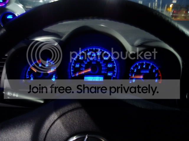

Drat. Do you think anyone might be there to possibly hook up something like that? I found a thread where someone did it, but they say its a pain to do. I would be willing to toss in some extra dough to have it done, since I don't think I'd be able to do it well myself and I have no freaking idea where I could get it done elsewhere.
The thread:
I basically want this but instead of blue I want green:
Old Apr 6, 2006 | 05:24 PM
  #72
Skeorx13's Avatar
Posts: 988
From: NW Chicago
hmm... well the guy that did this mod said it took him about 6 hours to do... He sectioned off behind the gauge and added an extra LED under the needle so the colors didn't bleed together. If anyone has some other ideas to get the effect i'm looking for I'd really appreciate it. I'm pretty **** about my aesthetics, so I apologize if i'm annoying anyone.

just take a razor to the needle and scrape back the amber on the needle and then add a blue transparent tape... or whatever color you choose. I don't know if it will work but I did that in my last car and it worked fine...
or go to imortintelligence and buy a 2large 2 small needle kit for 65.00...

well the needle painting/stripping only takes a few minutes. Its putting the led behind it and isolating the color that's the b1tch of it. If there was a way to maybe only replace like one of the middle lights with white and the rest green and be able to keep the white solely on the needle part then i'd be good. But i don't know the placement of the leds... so yeah.

here is what the led's look like

Hmm... well the lower led's i'd want to remain stock (cel, turn signals, abs light, etc. except anything that's amber I'd want green or white or blue or something. I really hate that amber color ) The tachometer and the gas and temp gauges i think i'd be screwed on... doesn't seem like the lights are directly under the needles at all. The speedometer though, is that center led directly under the needle? maybe if i just made that one white and the rest green, think that might do the trick? or would it bleed out the rest of the color? Are the two lower led's in the center for the odometer? If so, those I definitely want white.

Correct, the LED's light up the gauges and the needles. all I'm doing during this day is the LED swap. The day of, just let me know what LED's you want me to leave or change and I'll do it but I can't do the needles.
And yes the Greens will bleed out the white or Vice-Versa. That's why you're better off doing the left & right sections one color and the center another if you want a 2 tone. Also, what color do you want the AC controls as there is a price difference between Green & White.
