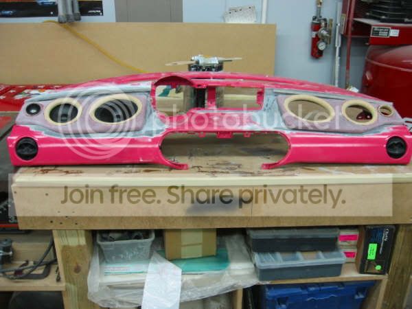

I did the pink one and i wouldn't recommend it, the dash started separating, not paint peeling, the plastic started popping off, taking the paint with it. I would only recommend it on a full show car that sits in a garage 24/7 when not showing. The texas sun is highly brutal and forces havok on mods like this. A 5 to 6 hundred budget is pretty low for these kind of mods because of the materials and time envolved, properly done each piece is going to need to be run through a bake cycle to get the mold release agents out. Price replacement parts before doing this would be my advice . Here is a pic of the pink one now.
