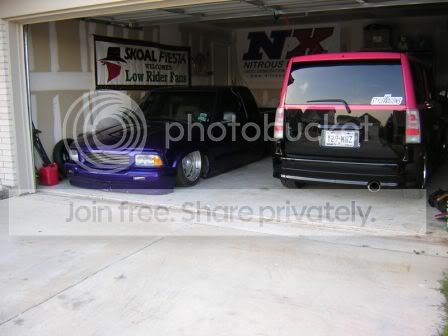

who says my tC still shows the height of a 4x4?
yup it still does, or does it? or will it still in the future?
maybe
ofcourse it will.......
maybe
