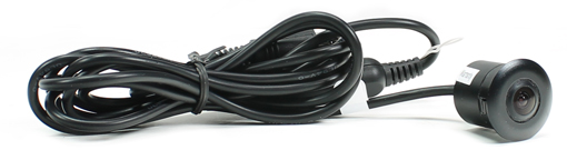

Hey guys! I have a Gen1 xB. I have a Pioneer in dash DVD player that has the hook up for the rear view camera. I've been really wanting to install one, but the thought of having to run the cable all the way from the hatch. And then how to run it, I talk myself out of it. Has anyone else installed one on their xB and how hard was it? Where would you even run the cable into the hatch from the outside without drilling a hole?

Fits into the wiper arm hole out back. Run wires through the headliner and through the 3rd brake grommet on the hatch. Did this to my 05 way back when
