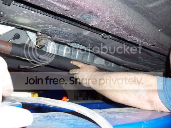

The center section, test fitted and welded together and positioned under the car.

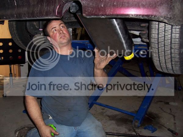

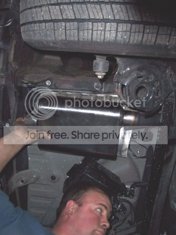

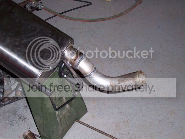

Chuck, fitting the muffler.

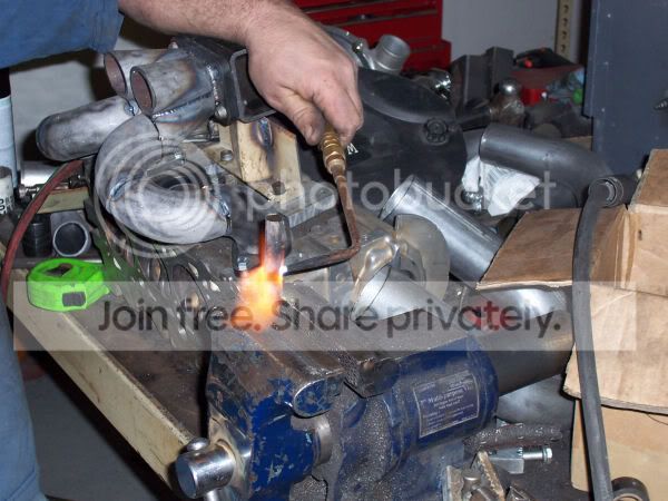

Chuck, bending up a hanger.

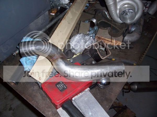

The over the rear suspension section test fitted and welded up.

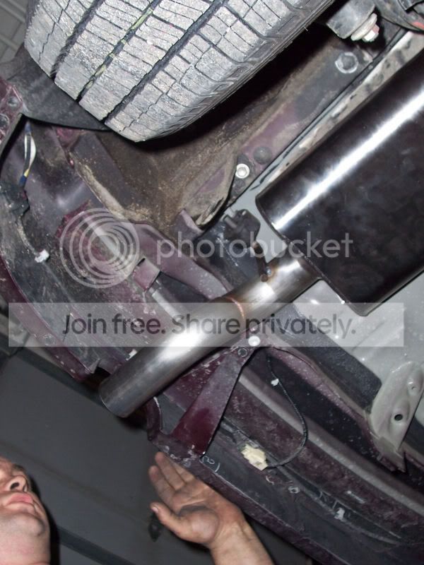

The stainless tail pipe.

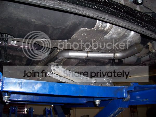

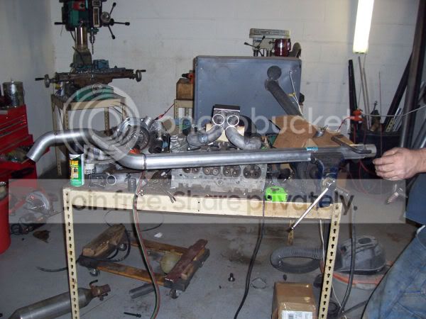

The center section out from under the car so Chuck could finish the welds.

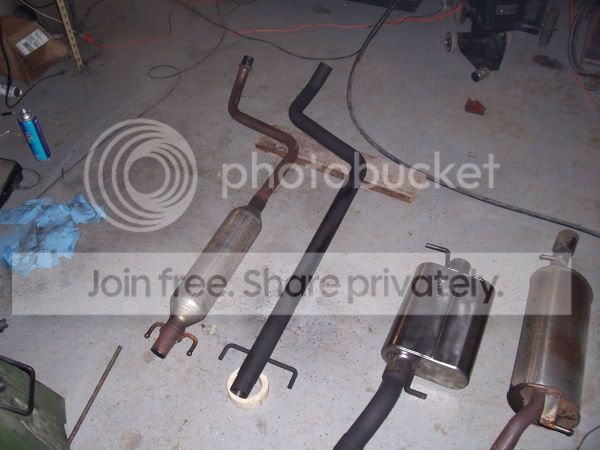

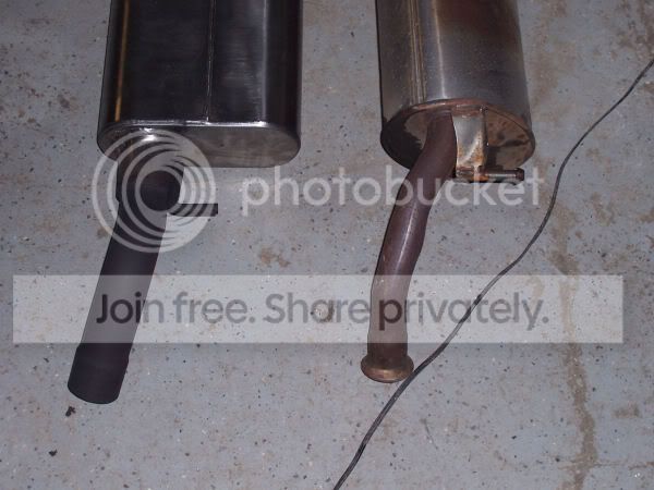

Muffler inlet compairisons.

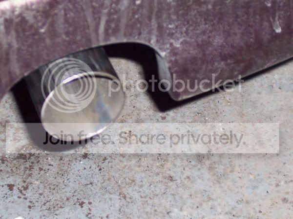

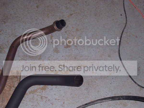

Tail pipe compairisons.

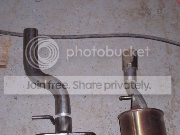

Center section outlet compairisons.
Center section compairisons.

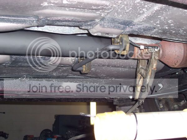

Mounting the finished center section. Notice the stock hangers are used.

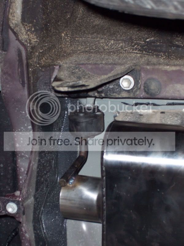

Mounting the muffler. Notice how all the stock hangers are used.

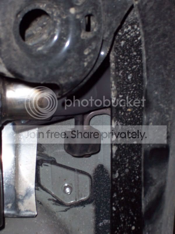

And the tail pipe.
And the tail pipe.
