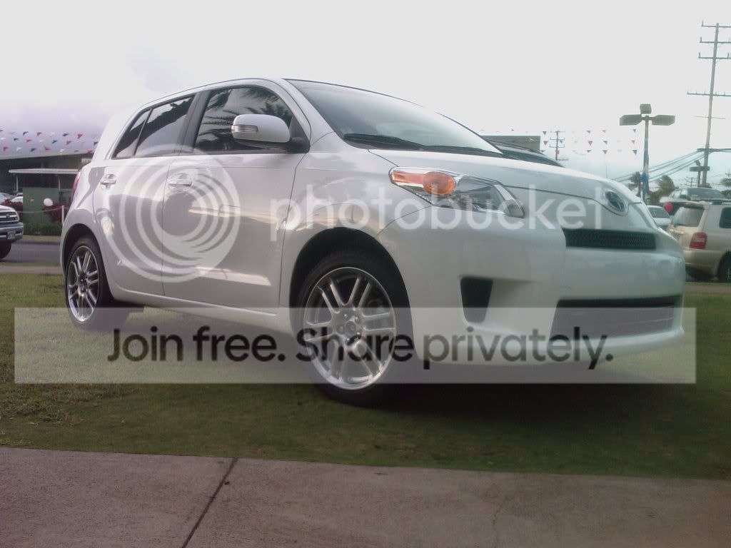

Well, you didn't tell us what model Scion you have. I looked at some of your previous posts, and if I'm correct, you have an xD. The xD came stock with 16" wheels, so you will need to get 16's (not 17's) if you want to swap your stock tires onto a new set of wheels. You also want to make sure the new wheels have a 5x100 lug pattern. Since the stock tires are 195/60-16 I would try to stay with wheels in the 16x6.5 to 16x7 size range.
Here's a picture of an xD on 16" tC wheels:

Might be a dumb question, but the 08 scion xd (which I have) came with the following stock tires:
Wheel Size: 16 x 6 inches
Tire Size: 195/60 R16
If I get the 17" tC rims above in this post, do you think I'll be able to keep my existing stock tires and fit the 17 rims on them without a huge problem? Thanks for the advice.

Your 16" tires will absolutely NOT work with 17" wheels.
The guy in the above picture wanted to keep his OEM 16" tires also.
Apparently in mentioning the tC wheels in that post, nothing was said about them not being 16's.
If they're 17's, then I find that posting quite misleading. Sorry for the confusion, I'll go back to the xB2 forums now.
Here's the original thread I took the picture from (see the first post):
https://www.scionlife.com/forums/viewtopic.php?t=203544

If you want to keep your 16" tires, you'll have to get 16" wheels. If you want 17" wheels, you'll have to buy 17" tires to match. I personally would go with 17" wheels at least.
Note: tC stock wheels are 17x7 +42 with 215/45-17 tires.
