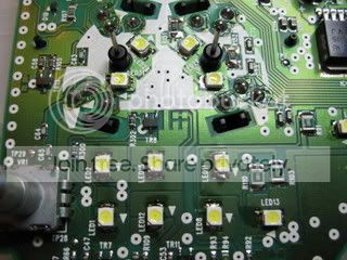

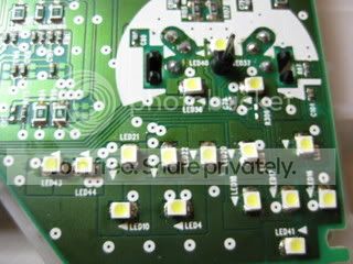

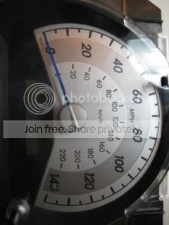

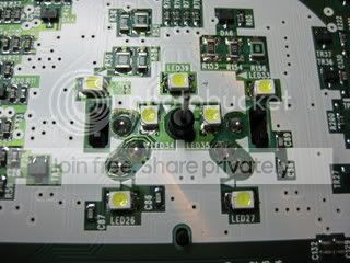

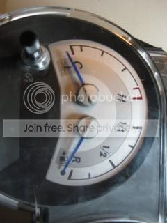

So I just got done doing my LED gauge swap. I guess it took a total of about 1-2 hours to solder the LEDs and resistors. The LED is white, the number on the gauge is blue, and the needle is blue. As of now I don't have any pics of it being lit up because I don't have my car with me. I will have those pictures on Friday so stay tuned. The following is what the LEDs look like.
If anyone needs help I will be in Portland this weekend.
