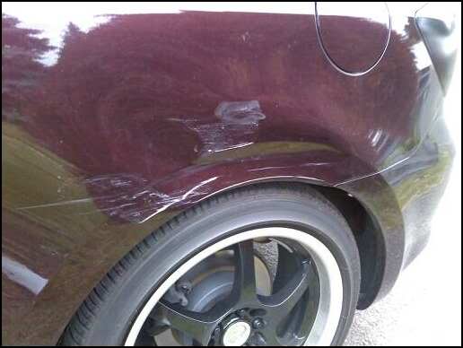

heres a pic of my car its a lil dirty, i just don't even care about cleaning it anymore im so upset... the worst part is i wasn't drinking just over worked and so exausted i might of well been drunk... any one have any ideas how to get dent out and fix paint... it could of been worse but man this car was my baby

thanks murderedouttc... ya im low on cash the next 3 months i have to save every penny or i'd take it in im goin to vegas in september i was trying to get this fixed before vegas since im driving there i don't wanna have a dented scratched tc in vegas haha... anyone know if the dent remover thing at the stores works its like suction cups or somthin???

Your best bet is to take off the interior panels to access that area (i've seen it when I did my speakers) and see what you can safely pop back out. When doing this, be sure to heat the paint up a little with a hair dryer or heat gun so it doesn't crack if you pop the panel back out. The scratches can be covered up as a temporary cheap fix but later on need to be addressed seriously to prevent rust. It might be pretty tough to use those crappy dent kits because our rear fenders are double wall welded. I found that out when I rolled mine. Take your time and keep the paint warm. Good luck!
