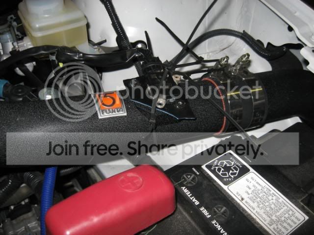

Bro...hit me up with a PM.... I actually made a solid patch for mine doing the same thing. I took all the mods off my 06 tC before I sold it and installed them on my new 08 tC. and one of those parts was an 06 Injen CAI
If you're serious about buying that one...then PM me...and the cost is dirt cheap for the CAI...b/c in order to make it work you WILL need a MAF sensor off of an 05-06 tC. Which generally isnt cheap. I happened to have one b/c I was making the switch on both tC's at the same time. This swap mod can be done...but unless you're getting the part cheaper than hell....listen to the rest on here and buy the correct one for your year of tC. You will have a lot less headaches.
For what it's worth...here's the pic off of my SL profile of this mod finished on my 08 tC....

Well just for kicks I installed the 05-06 Fujita CAI on my 09 tC and used the MAF adapter from randode.com. Everything lined up and installed just fine except the mounting bracket was about an inch off. I drove about 200 miles on it and never got a CEL. It sounds amazing and can feel some more lower end power. So this setup will work if you dont mind drilling a new hole for mounting purposes.

I did the same thing. iv got a 05 or something Fujita CAI on my 09... fit in fine but the sensor doesnt fit. i made some modifications hahaha....

iv got like a rubber gasket looking thing and it seals off just fine. no problems from it yet... keyword is yet tho
