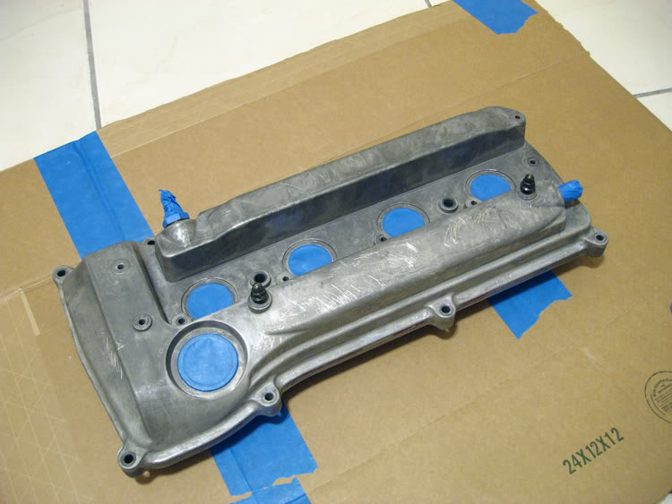

BTW ... mask off the oil cap area and under neath if you continue to sand.. you do no want metal particles floating in your oil... and keep it masked till your done with clear... it should look like this..
my old valve cover project...
pre ANYTHING... a goo wash and cleaning then masking

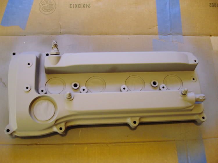

then u can start to wet sand for primer then apply the primer..

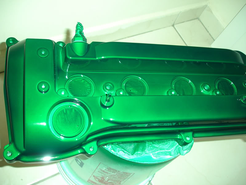

then paint and clear... leave the removal of the masking for the very very end.. this ensures no foreign particles form paint, or metal or clear or anything are underneath waiting to mix with the oil.

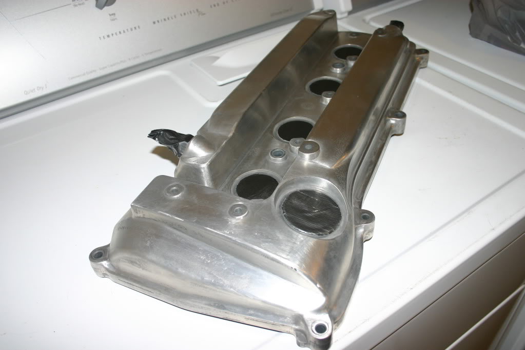

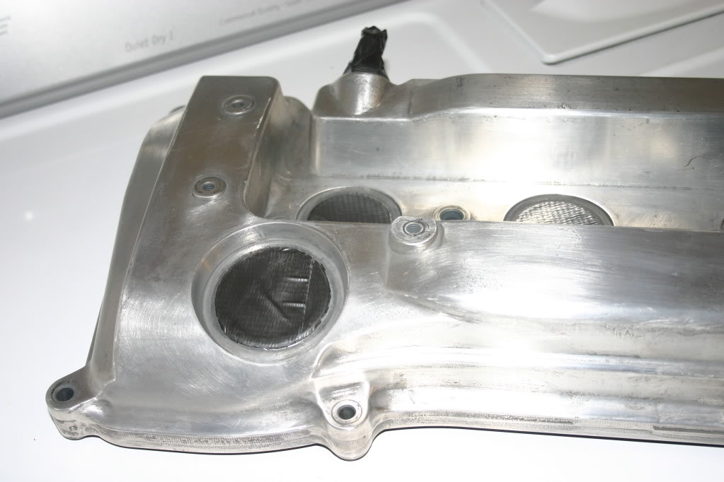

this is after the 2nd and 3rd sanding:
i should be ready for the primer... here comes some more sanding... lol
