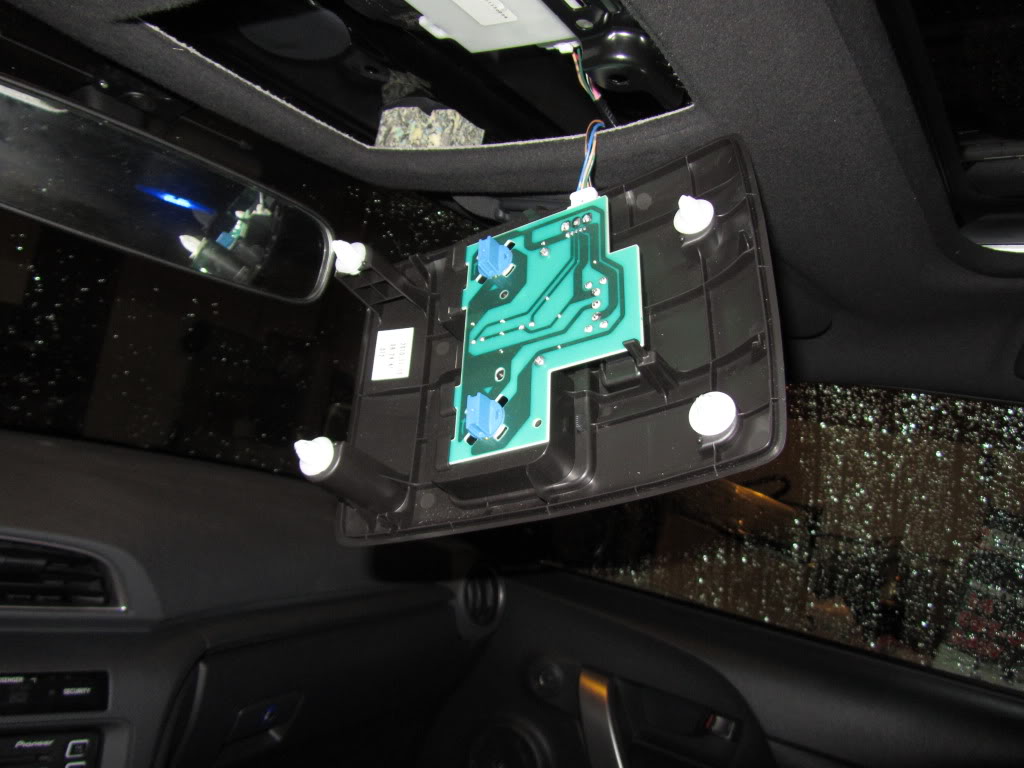

Front Dome Door Switch Tap-in
HUH/WHY?:
If you want to add lights that only come on when you open the Doors
The door switch designed in a weird way to be a negative trigger aka when doors open -12V is being fed into the lights.
In this setup I am not sure if you can still ground to anywhere on the car which is why you should tap into both wires that I will show
Push up on the headliner from both sides in the front of the dome assembly and you'll see white clips. Pull down really hard. Do the same for the rear part
Blue wire(left) is positive 12V and the black(right) is ground! Tap into both wires!

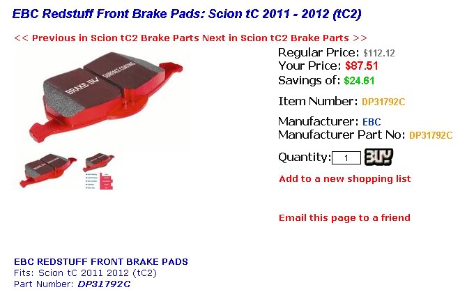

After i paint front rotors and the pads burn off all the excess paint im getting these:

Just getting front pads?

that's only ones they have out - the fronts

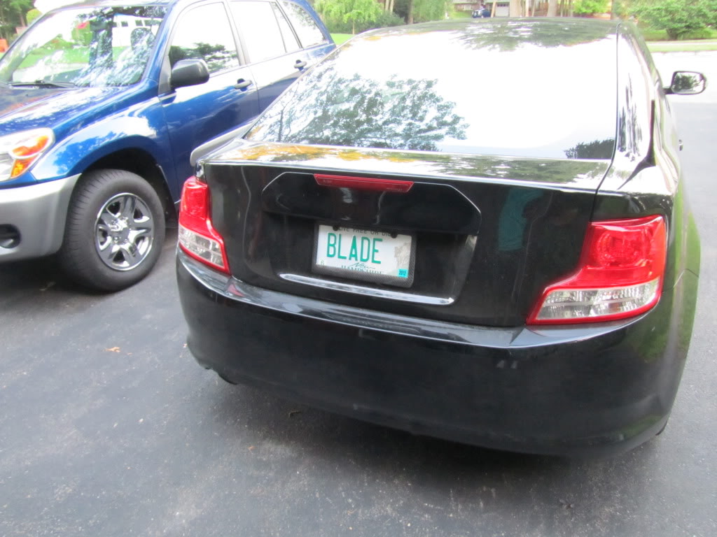

Red NiteShade for center brake light
b4
after

Looks great!

i still have to sand it and use a polishing compound.
It should look much better after

Nice.... You going to do the tails next

Honestly, that looks even better than I expected!

It's darker than I wanted, 1st coat was way too heavy
but i think it still looks good/will look better after sanding
haha heLL no! maybe smoke em a little the way MightyP did it

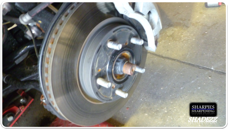

Originally Posted by Scion202
XB2 and tC2 have the same rotors....maybe, I know they have the same bore and fit the same hubcentric spacers
no trd pads for stock brakes
most lines are standard size. 2tCornot2tC said that he tried em and they fit.
Nick and I will confirm one way or the other this weekend
I can ensure you the Hub size has changed from the 08-10 XB's to the 11-12 XB's current updated size....I could not tell you about the TC's, but all of us XB peeps would like to know if their they same as yours. Also wondering why Scion would make a bigger hub for the new model years?
