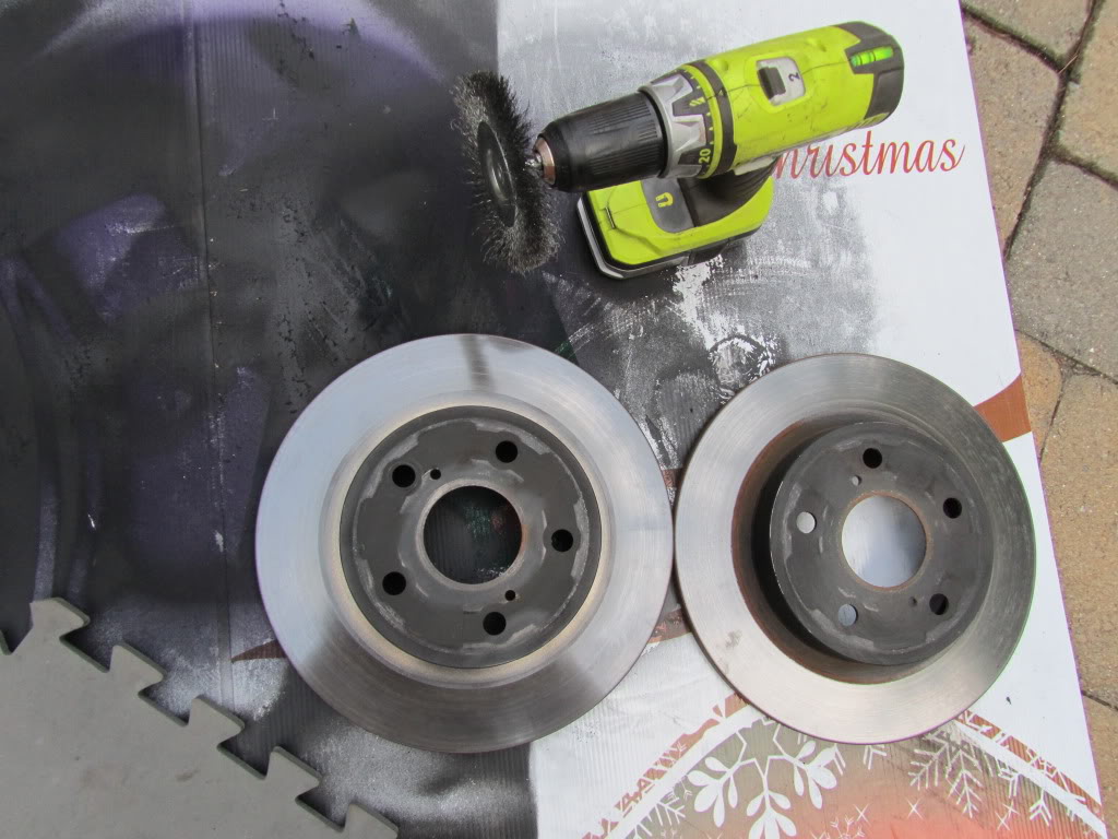

as for the spacers, the nuts on the spacers are 17mm or w/e US equivalent is close to it. I wouldnt torque em any higher than 70 foot pounds. Also clear the hub before putting the rings on with something like this
and apply anti seize
then re-torque after about 100-300 miles

Can you go into a little more detail man?
What do you mean by 'clear' the hubs? Sand them down smooth? What do you have on that drill?
What am I looking at in this picture? I've never really messed with wheels before. This car is the first car I've ever worked on besides oil changes!

you see here that middle part(bore) is rusty, so use metal brush to scrape it off thats it

Do this so the little ring that is included with the spacer will sit completely flush?

yeah so it sits all the way, i had to clean mine before i could even put it on
