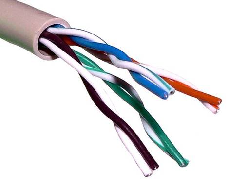

5. Get one pair of wires from an ethernet cable or other 24/26AWG wires preferably black. Unfortunately ethernet pairs arent black
6. 10" wire is long enough

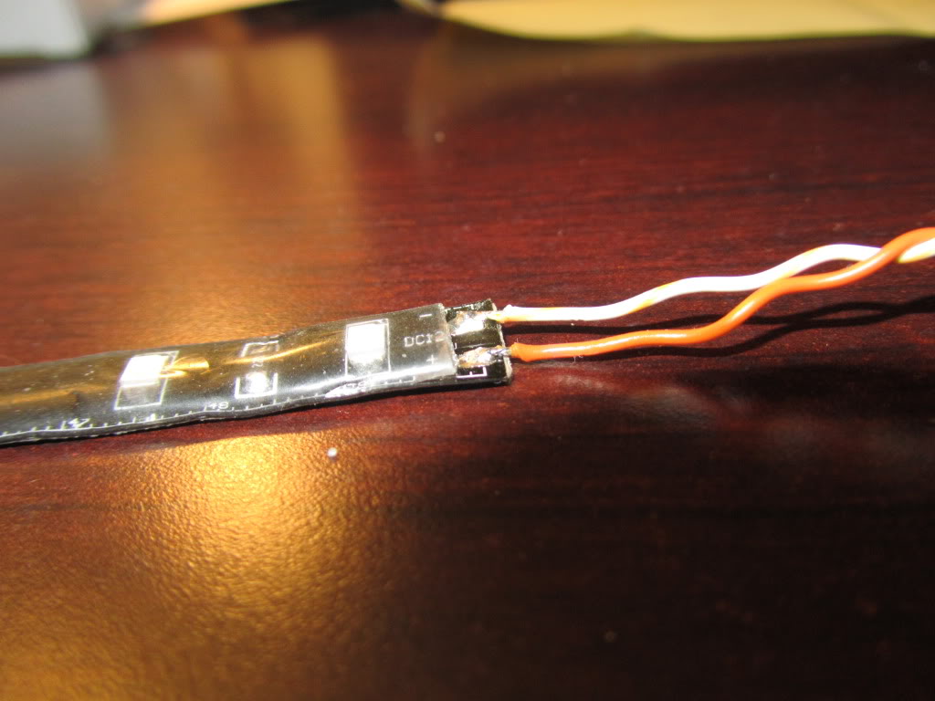

7. Cut away the silicon from the LED strip to reveal the soldering contacts.
8. Strip the wire and solder to the LED strip contacts( I do that under a microscope)

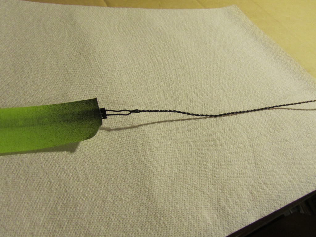

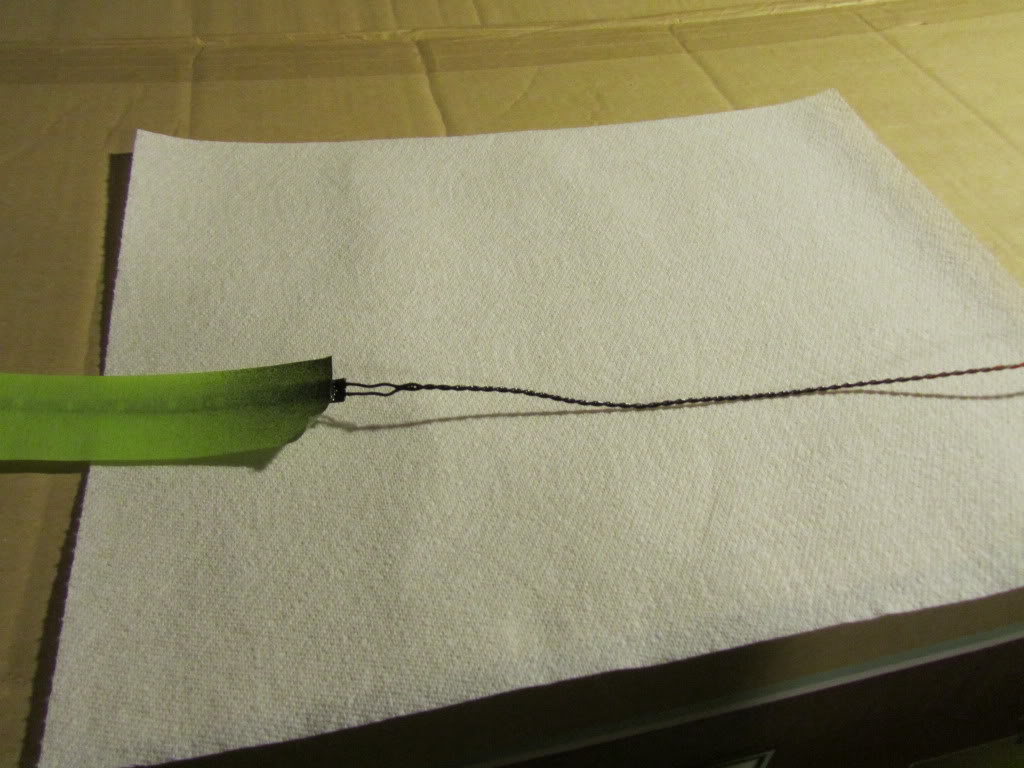

9. Mask off the strip and using liquid tape spray on the soldering joints
10. Let it dry for however long it says on the can
11. Grab a 9V battery and make sure that the LED strip lights up. While the LED strip connected to the battery, place the soldering join under running water to ensure that contacts have been completely sealed by the liquid tape.

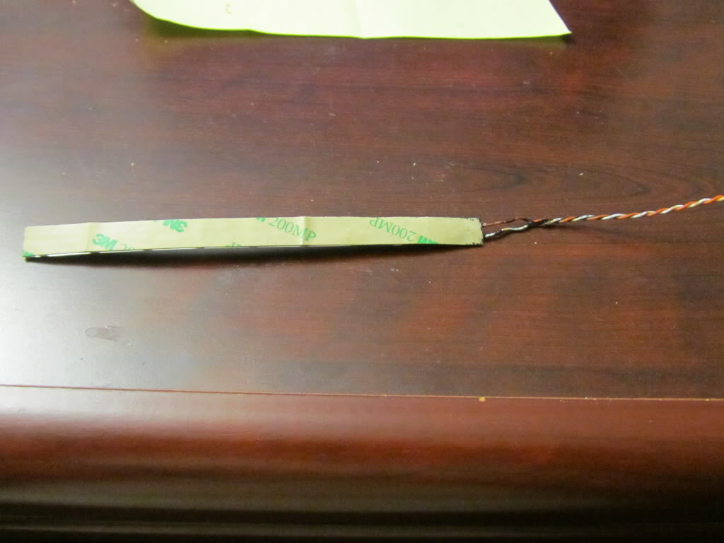

13. Heat shrink the joint area for added protection/water resistance
14. The strip is now ready to be put on the car

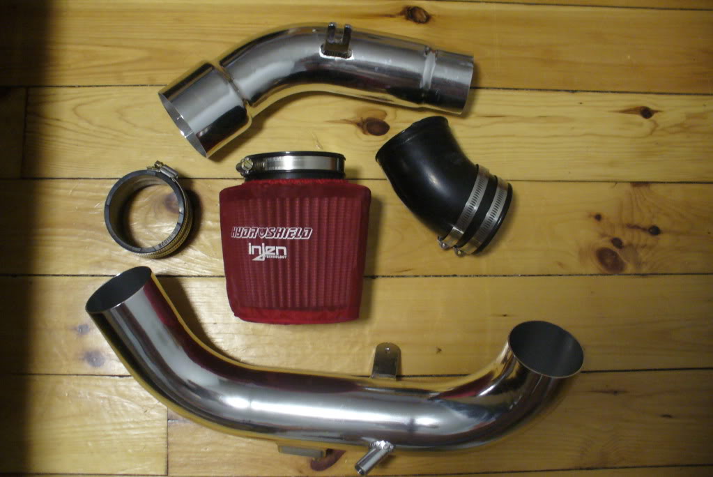

For sale takeda intake. Purchased for $260 in July. Also comes with Injen Hydro Shield $26.
I think 1 little screw is missing. Sold as is.
Price: $100

you mind me asking why you are selling it and if it has anything to do with the check engine light problem??
Old Jan 6, 2012 | 06:41 PM
  #976
devanb3's Avatar
Joined: Apr 2011
Posts: 702
and would you be willing to post a couple of night pics with the led fogs thanks
Old Jan 6, 2012 | 06:58 PM
  #977
Scion202's Avatar
Joined: Mar 2011
Posts: 2,102
From: Nashua, NH
it threw a couple CELs at me. Then I realyzed that part of it was because it was getting moist because it rains a lot up here and as a result wet filter blocked air...
also its a super tight fit with Cusco
So im only gonna do SRI from now on
I called Takeda and they said they can resolve the CELs with some tubes or a different filter but no money back because I didnt buy it directly from them.
So whoever gets this and has a CEL can contact them with the code and they will try to clear it.
