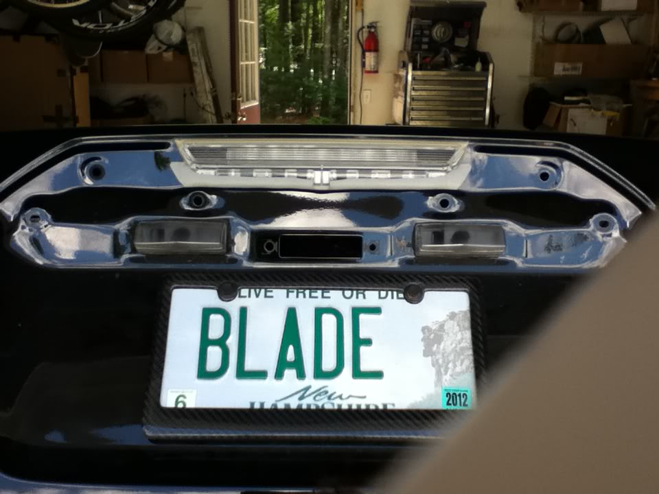

I just brought it to a body shop and picked it up 2 days later. The place is supposed to be very good(the guy who recommended it deals with customers that have Ferraris and Maseratis and got his own 550HP civic painted there). Still the guy honestly told me that there could be a halo effect with a chance of 30%-40%. There is a white 2011 Scion on here that used bondo and i think he is still fine but then again I dont know what they used at the shop....maybe they have some special formula
@dan
just a pic showing the holes from inside

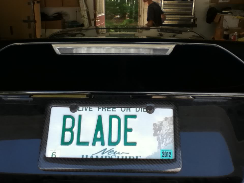

So the rear scion logo comes off just like the TC does? No screws or indent where the emblem is placed? Just comes clean off (minus the adhesive tape)

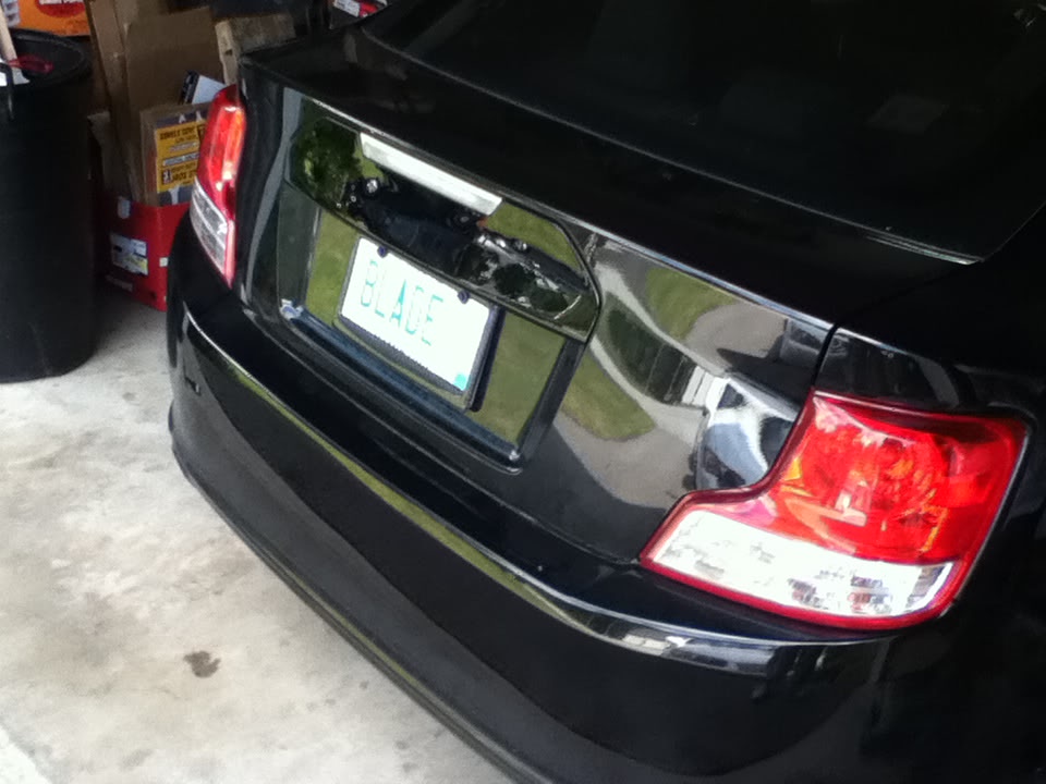

Originally Posted by r2dnel
Very nice...
I just bought the rear panel and brought it to the body shop where they filled it

Where did you purchase the rear panel? How much was the body work

http://trdsparks.com/part_detailfrom...76811-21100-C0
With shipping $115
body work was $100

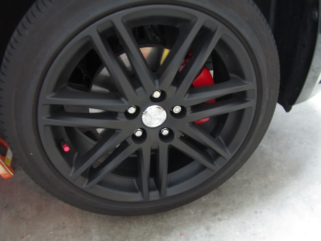

Plasti Dipping Right side:
1 heavy coat inside

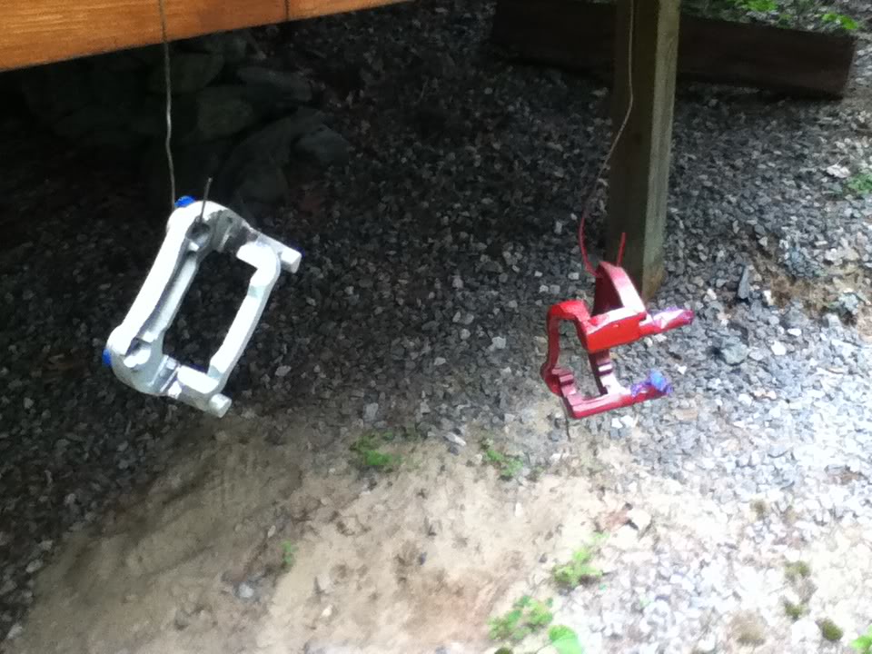

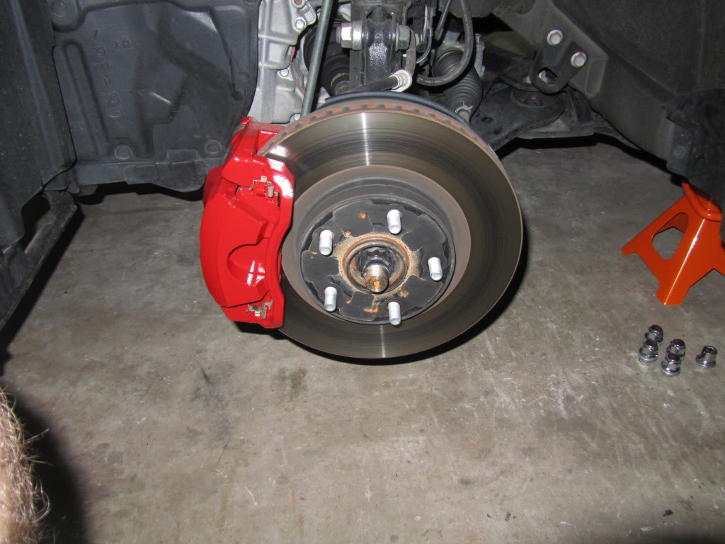

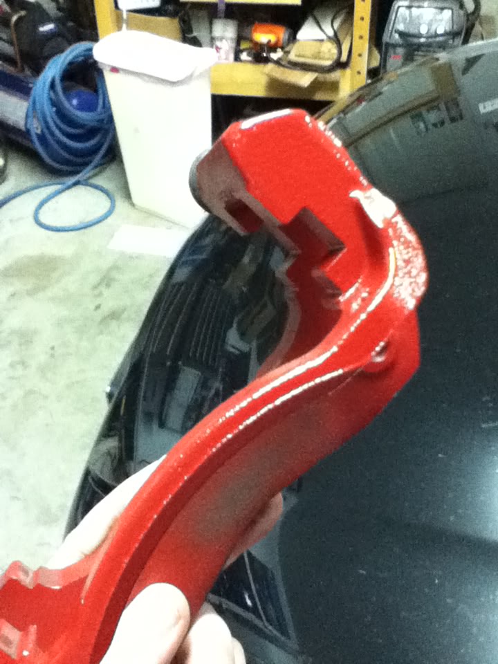

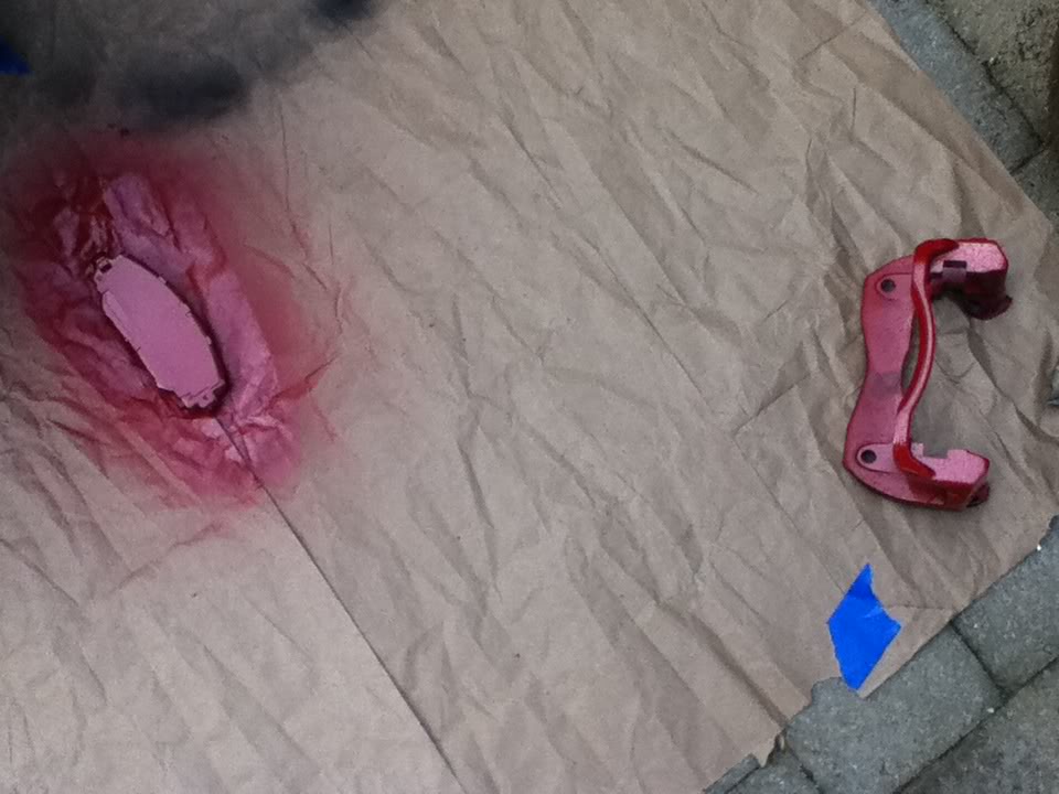

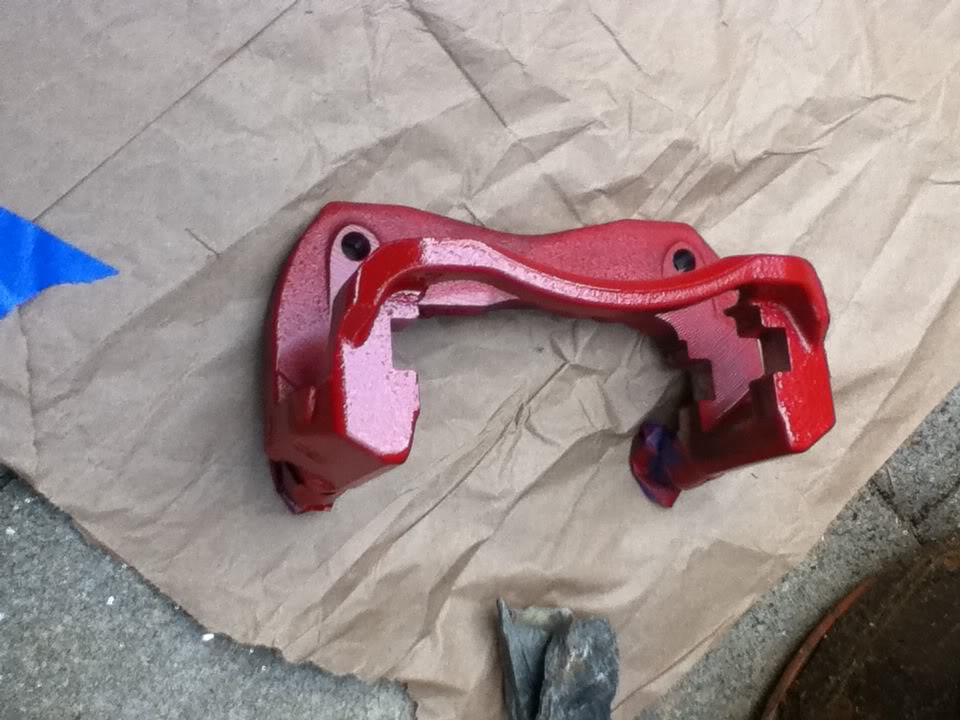

Calipers:

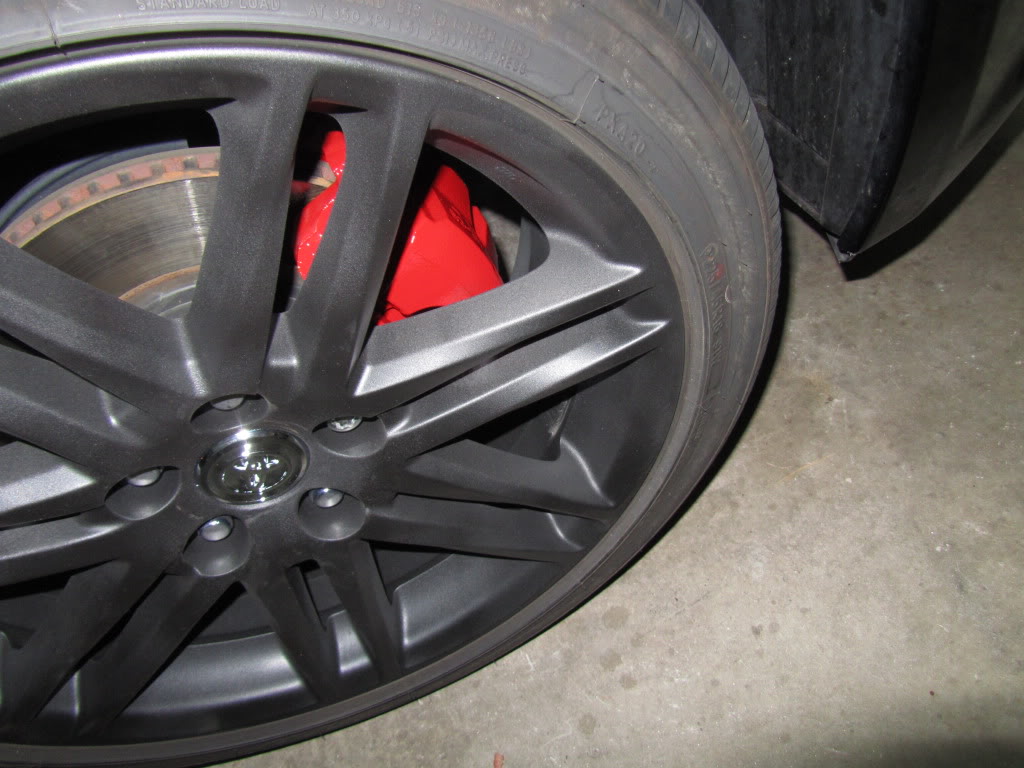

Dried:

Overall:

Debadged pics:

Awww **** you took my idea plastidip black rims with red calipers I love it looks great!

How many cans of plasti-dip did you use bro
Old Jul 3, 2011 | 07:09 PM
  #157
Scion202's Avatar
Joined: Mar 2011
Posts: 2,102
From: Nashua, NH
3 coats. 1 can per wheel

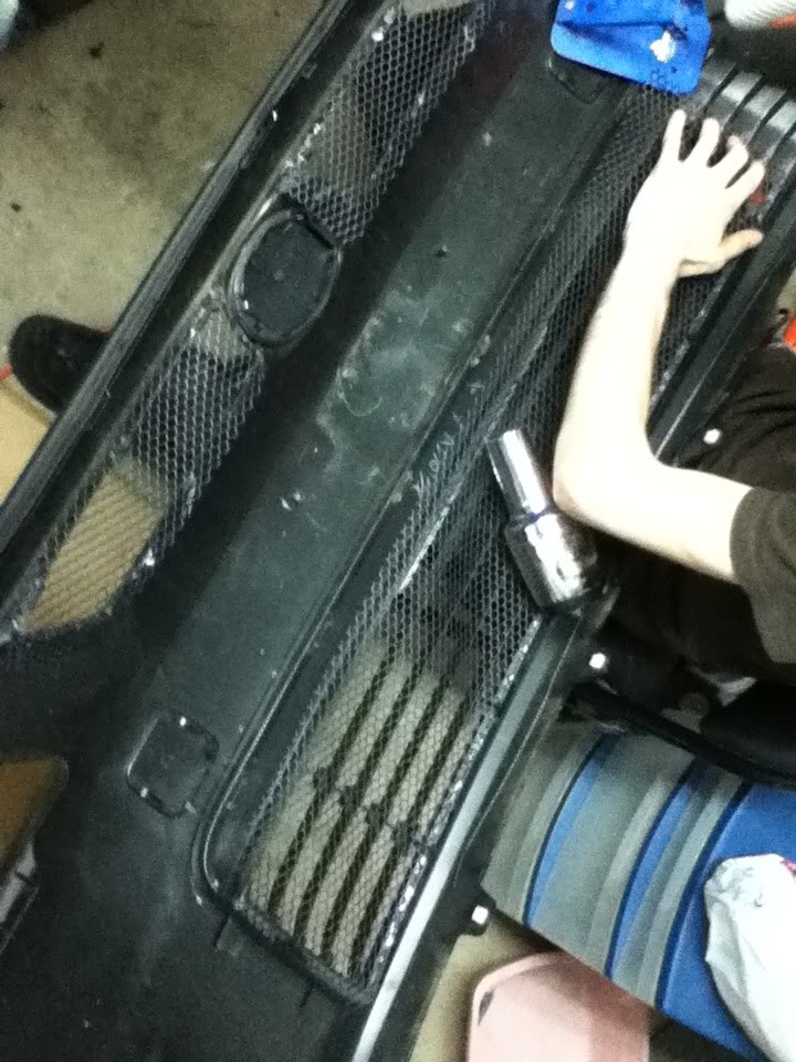

Grille Plastic Mesh
Hopefully it will keep the bugs out of the radiator

Looks good! Nice thought for looks and functionality.

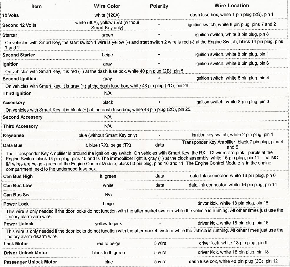

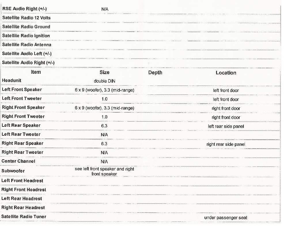

This is the wiring diagram to which I will refer to when writing up all DIYs
