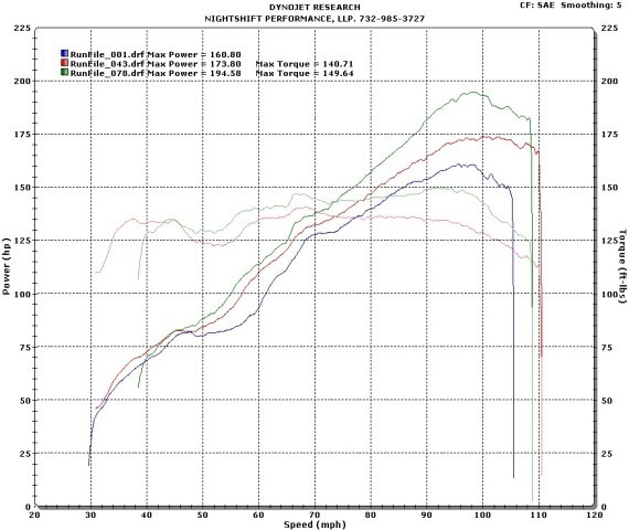

Both cars are running stock tires that arent grippy at all so i wouldnt expect them to chirp in 3rd. Just showing ppl videos of a stage 1 tune in a stock car on the frs. It fixes crappy idle(for those who have an frs and their rpms bounce), raised rev limiter from 7500 to7800, increases gas mileage, and you also get launch control and flat-foot shifting that you saw in first video. Thats why it bounced at 4300rpm.on a dyno it put done 11-15hp and 4-6lbs of torque throughout the power band on 93 oct. On E85 it put down an extra 35hp.
First run is base
second run is 93 octane
third is e85

Naw man, just thought there was more subject matter here to discuss than talking about chirping tires.
Subject such as the removal of the dip at 4k ish RPM's.
Also from the 93 octane tune the calculation of 9.3 1/8th mile run is older 350z VQ35DE territory (I was running 9.0-9.3 in my stock 03 350z). Good stuff for a completely stock car with just a flash of the ECU. Wonder why Toyota/Subaru didn't provide this kind of tune from the factory.
Interested in seeing the 1/4 mile numbers from just a tune and maybe some decent tires.
E85 tune is dang near 200whp. Curious to see what full bolt-ons will yield. The exhaust systems seem to be pretty sufficient even in stock form.
